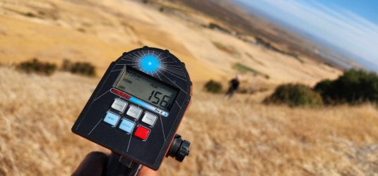

Ok. So we had great wind and direction yesterday, got to really put the test to the Wazzup and got it to 156mph. But had a catastrophe and one of the surfaces fluttered bad and turned the plane into the hill. Boom.
I’ll add a link for the video, it is too large to upload

Ok. Here is the video. Nothing I could do once the flutter occurred, it went straight into to hill. I was close to the hill in the bottom of the turn to get into the groove here at the Slot. It is where the fastest line is. Again, this plane was not built for this, it is a great flying plane, but I was challanged to push it to see what it could do. I know it had a bit more, but my guess is one of the ailerons broke loose? It was a really loud flutter you can hear it at the bottom turn before impact clearly.

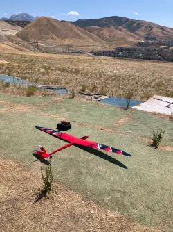

Just maidened Wuzzup. Pretty straight forward build. Squeezed kst x10’s mini in both ailerons and flaps. Ailleron covers are a little proud but still taped down nicely. I can tell it’s going to be a favorite. Nice work Eric and team. This thing rips. First bird on Frsky so need to program a bit more. Hopefully get some ballast in next time. Ted

Excellent! Looks really good sitting on the slope, but bet she looks better in the air. :)

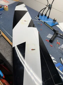

My 2nd Wazzup is done and ready to maiden!! I finally got around to d to making it and I changed the pushrods from bottom to top skin this time and used K2M horns for some extra height (and leverage for the servo). All programmed and CG’d. It took 11.5oz of nose weight to balance.
