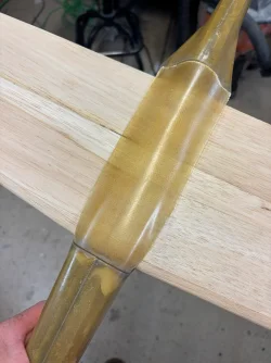

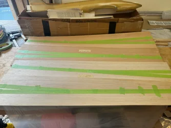

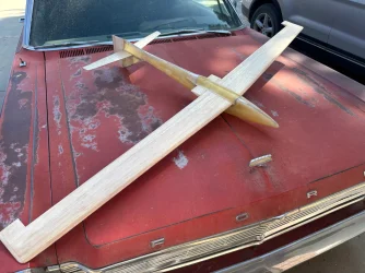

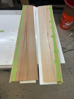

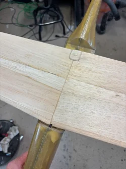

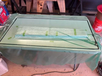

I've got the Songbird wings sheeted and basically finished, less cutting the ailerons free. I need to have the wing mounted before I bond in the stabilizer so I can set the incidence, so now I can do that. I think I will glass the wing before I cut the ailerons loose. I like to do that to keep the ailerons from warping. Pretty straight forward build so far. I'm thinking I'll have it in primer in a week or two.

Going to be a neat plane, can't wait to see the scheme you come up with.
I'm still mulling that one around...really not sure yet. Probably not race livery inspired on this one though, leaning towards Dave Brown's Tiporare (the one with the checkers) scheme which was sort of a cream and root beer brown but not settled on that yet.

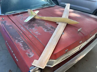

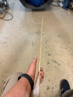

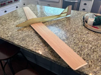

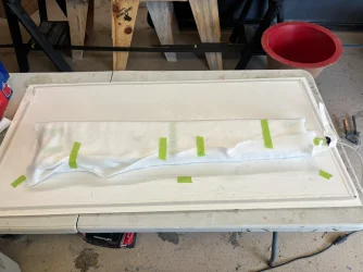

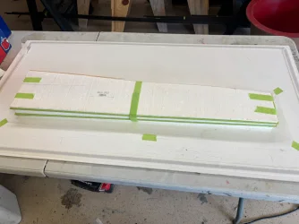

I finished all the glasswork and was able to get the stab mounted at the correct incidence. The ailerons are cut out and torque rods fitted. The belly pan is glued on and hole relieved for the wing bolt. It needs some body work where it meets the wing, then the whole wing needs its second coat of resin. The ailerons need to be faced and a second coat of resin applied as well. From there its final sanding and then get it in primer.
I have all the servos and radio gear, that should all be pretty straight forward. Going to be really close to get it done by Sunset but I’m trying.
