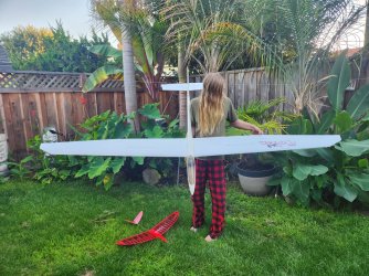

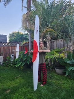

Home stretch. One more ready (Lightning Bug - just in case:giggle:) Last one on the bench - never flown MPX Flamingo 2001
