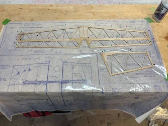

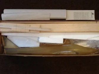

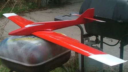

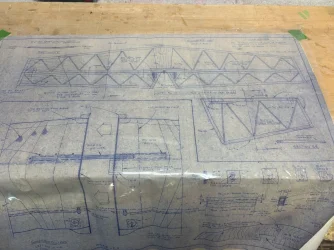

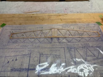

The first real build is a Songbird by JM Glasscraft. I lusted over this one as a kid in the '70s, so when the kit popped up I jumped on it. I'm a sucker for those low-wing birds! It can be built as either a 2M or 100" span and two different airfoils, I have not decided which to use yet. It has foam cores and Balsa sheeting from Sig that is the lightest I have seen in a long time, let alone supplied in a kit. Easily contest-grade wood for those who know what that is. The fuselage is nicely molded with included wood hard points and rudder post already bonded in. The overall shape reminds me of Hanno Prettner's Curare pattern plane of the same era, so I'm considering adding anhedral to the tail to mimic the look of what was en vogue of that era.
I started by framing up the stabilizer, but quickly realized that my glue was stale. So, an order to Aloft will have me fixed up and back going in a couple of days. In the meantime, I need to order some .75 oz. glass cloth, I think this one is destined for paint.

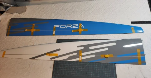

Thats awesome Red, looks like a super fun plane. I am hoping to finish my Z1 this week and then Im finally going to start on my Forza with the intent of maidening it at Sunset, if the winds cooperate.

Looks like that Songbird is going to be aerobatic as hell.

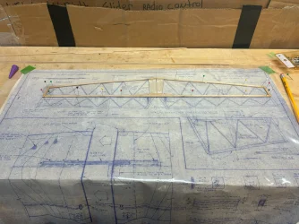

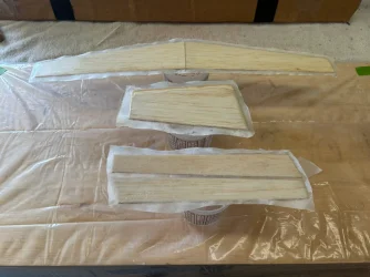

Thanks to Wayne and the Aloft boys, my candy order came with some glue and fiberglass cloth. So I was able to finish building the tail. The skeleton is all 1/16" balsa, and then the whole affair gets sheeted with 1/32" balsa except the rudder, which gets 1/16". After everything was finally sanded to shape, I beveled the hinge lines and put the first layer of light fiberglass cloth on. (thanks Wayne!) BTW, Jeremy, this would be an easy and light way for you to build balsa Zupair fins. Those eagle eyed will probably spot that I did cut some anhedral in the stab.
The plane is sort of interesting as the manual mentions a tow hook and thermal flying which seems a bit odd to me, but I guess that is where the 100" span option comes in. I have decided to go 2M span, one-piece wing, and probably just ailerons and use spoilers for glide path control. The elevator and rudder are supposed to be pull-pull cable actuated which I will switch out for mini servos and carbon pushrods. No idea on colors yet.
