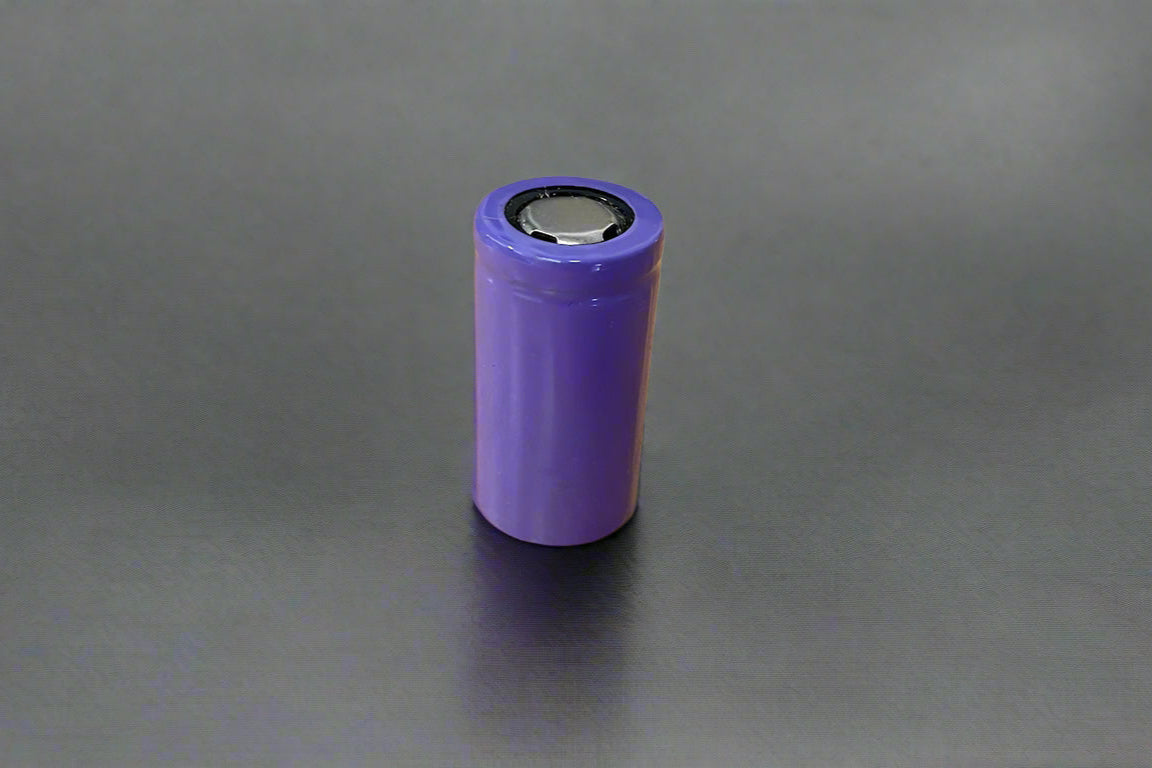

Wiring will be a bit different with battery on both sides. Curious if these might fit:
