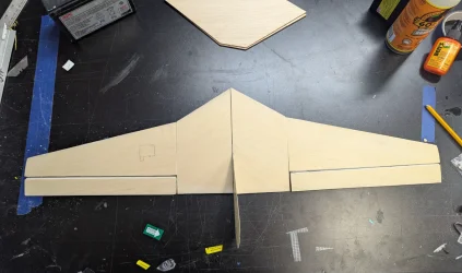

I went back and looked thru the photos of old planes of mine. I think the reason i keep them straight is that i usually use premade aileron stock on my planes and so its the same across.
On this little wing i did a few years back i did do the 25% at each ends (gets smaller at wing tips):

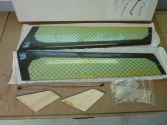

But than i went and looked at an old picture of my starfires and it keeps the shape out to the wings, looks kind of similar to how the woody looks above. And i like how that plank flies a lot. But in the picture i noticed my Zupair z1 and it looks like the elevons get bigger at the wingtips, so i went and found another picture and they definitely get bigger. And i love how that flies too.

View attachment 23393View attachment 23391
Good stuff!

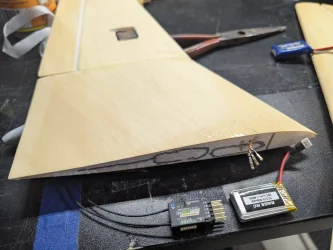

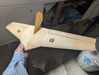

Get some gap seals on here, being a plank I think these elevons will be challenging, but probably fine. You will not want any play in them!

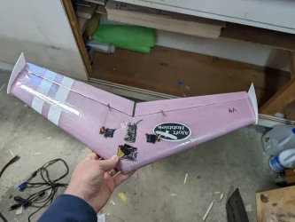

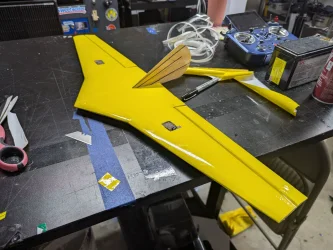

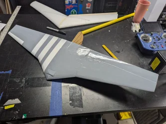

Hmm.. Poly would take some time but could be really pretty. I'd lean towards colored covering, but you can always switch to that if she gets a little rash on her.

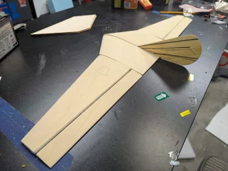

I think I can push a chunk of epp in my hatch to lock some lead in the nose so I can adjust it. I will go slightly nose heavy, like 4.15" vs your 4.25 on first toss and adjust.
