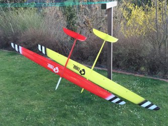

I developed the THOR in 2012/13. At the time, it was my second mould-making project and the first one completely of my own. That means I also designed the airfoils myself back then. Since I lent the master moulds to colleagues in Austria and Germany over the years, quite a few mould sets were created and, accordingly, there was also a lot of feedback from pilots about the flight characteristics. On the whole, the THOR covered a fairly wide range of uses and also showed a good-natured handling over a wide range. However, it needed a comparatively higher wing loading to be able to keep up in competition and at sub-30 speeds an unpleasant undercutting began. Now you rarely have such fast conditions in competition and if you do, the pilot has to be able to fly it. However, in normal slope soaring, you can quickly reach these speed ranges.​
Even 11 years after the birth of the first THOR, this model is still being built in private workshops and serve as entry-level and training models. Somehow I think that's pretty cool and it also shows me that the overall concept was not entirely wrong. So I took it up again and with TJIRC I found a suitable manufacturer.

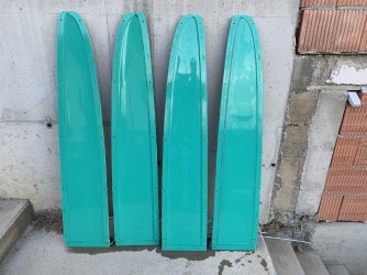

Yes, the production of the moulds has already begun and, as far as I can see from the pictures Jerry sends me, it is already well advanced.

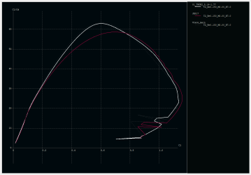

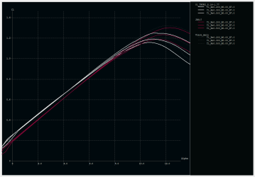

When designing the airfoils, I first had to decide which path I wanted to take with the THOR.2. Should the model be designed for rather weak conditions, or more of a model for chasing the F3f world record? Or should I rather look for the happy medium? A good-natured allrounder, as the first THOR already was? Well, as I mentioned at the beginning, I decided on the middle way because I think that such a design provides a more useful overall package for rookies and hobby pilots.
Showing airfoil polars out of XFLR5 is nice, but it only becomes interesting when compared with other known airfoils. In my search for suitable comparison airfoils, I came across the JH817 from @Doc J . He writes about this airfoil that he designed it for fast slope racers/allrounders. Unfortunately, I don't know on which specific models this airfoil is used. At 8% thickness, it is only slightly thinner than the base airfoil of the THOR.2; the camber of 1.77% is the same for both. This seems to be a perfect sparring partner! DocJ has kindly published the airfoil data.
If you look closely, you will see an additional polar, namely that of the Vrace (Vantage.race). The similarity now reveals the parentage of the THOR.2
The following picture shows the JH817 and the Thor.2 base airfoil in comparison. In the area of the main wing with a class-typical surface depth, we are moving in the range of Re200k - Re500k, depending on the flight speed. Anything above that is really very fast and rarely occurs in competition.
What we can see very clearly here are the obviously very different approaches of the two of us. Looking at the Type 1 polars (constant speed) alone, I would say that the JH817 should show very good acceleration in competition. This is particularly advantageous when building up the altitude (‘bowling’) in the first 30 seconds and entering the first leg. I had followed a very similar approach with my Vantage and the JX-GS series also goes in this direction! However, flight measurements have now confirmed that in the F3f course, you not only fly in these very low cL ranges, but use the entire lift spectrum. Depending on the (possible) flight style in different frequencies. An F3f allrounder must therefore cover a wider cL range to score points.
But drag alone is not everything. To be successful, you need more, of course. For example, (maximum) lift.
In my opinion, the F3F competition is decided in the 10 turns. Sure, speed on the course is also important, but the speed must also be brought through the turns. Depending on your flying style, you need either high lift reserves in the medium CA range (EM style) or in the high lift range (Bank'n Yank). Ideally, even in both ranges, but that´s a little difficult :). The following picture shows this:
The JH817 is definitely a representative of the Bank'n Yank genre. In DocJ's posts, I often read the term ‘fast turns’ and that seems to be a strength of this airfoil. The THOR.2, on the other hand, has its strengths in energy-management style. However, there is also enough lift reserves for tight turns. This high lift maximum is also an advantage in the F3b high start!

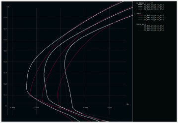

Finally, I would like to show the polar curve (type 2 – constant lift). This is not entirely irrelevant for F3f with its total of 10 distances, especially at slow speeds. However, the THOR.2 (like its mother Vrace) should also be able to perform in the F3b and F3g classes.
I deliberately kept an eye on this during the design phase and expect a thoroughly good performance in cross-country flying. I think that this was not the top priority for the JH817. But at maximum climb rate, DocJ's design is slightly ahead.
That would be the basic airfoil of THOR.2. Further out on the wing, I use Re-number-adapted and slightly thinner airfoils. I'm still looking for a sparring partner for comparison purposes here...

Great post Mario!
I like the comparison with the JH817 as I'm sure I have flown this airfoil as I have flown all but one of Hammond's designs. I will say as a sport pilot I really like the way Hammond's planes perform, and yes, I am one of those guys that really enjoys a bank and yank kind of plane. Pretty sure the JH817 is an older airfoil at this point. Hammond is always doing little tweaks. Not sure what all he did on his F3F models based on the RedShift, but liked that he was willing to do something different in planform and airfoil.

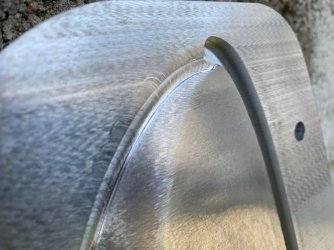

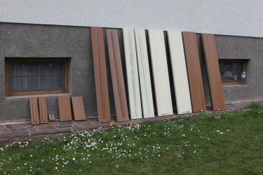

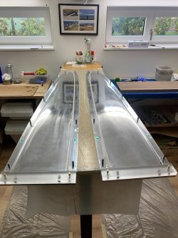

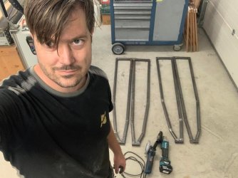

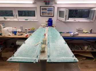

CNC-moulds, master models, etc. are expensive. Fortunately, I am able to mill such parts myself. The limiting factor is time:
024.jpg 386237276_10227162182772693_8450426336265083822_n.jpg 031.jpg025.jpg 027.jpg 028.jpg029.jpg 030.jpg

Nice-looking moulds. You say you can do the CNC yourself. Do you have a full-sized CNC milling machine at home?
