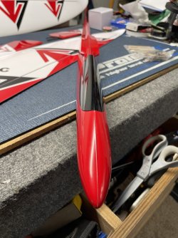

Just received my Wazzup! Packaged fantastic as always from Aloft!
First impressions and images for you all.

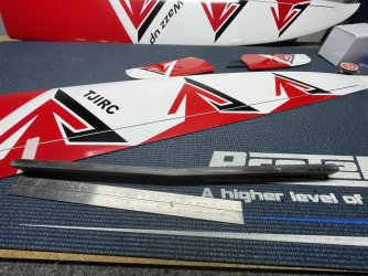

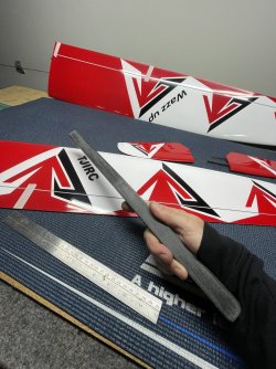

Beautiful looking plane! Has a real stout rectangle carbon spar. A real plus for me. I do not like steel rods (they bend too easy).

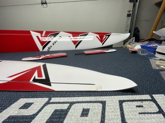

Nice color design. Has curved up wing tips. I like the look, but a bit weary if it will cause tip stalls? Only time will tell once I get it flying. The last plane I had with curved wingtips (Opus) tip stalled bad if you slowed down too much.

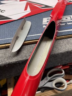

The fuse is a triangle type shape, tried to get that in the pictures.
Wings feel nice and stout as I like, same goes for the stab. Has a bell crank with easy access which I assume could be removed and install the elevator servo in the vertical fin if you know how to build decently. I’ll probably just put the elevator in the front and see how she does first.

I first looked at the wing and was impressed as I thought it might have a light layup, but it has a pretty serious layup. She feels substantial and looks really nice. Good sized flaps and ailerons. Then jumped over to the fuselage. I have to admit I have not seen a fuselage like this one before, but I really like it. It feel at home in your hand and is a great compromise for both slope glider or electric glider. If has room for a big battery and motor without seeming big. A nice mix for both applications. But that flat bottom really feels good in your hand. Should make her a joy to throw out into the air.
The pushrods are pre installed for the rudder and elevator. Just need to plug in the elevator into the all carbon bell crank.
