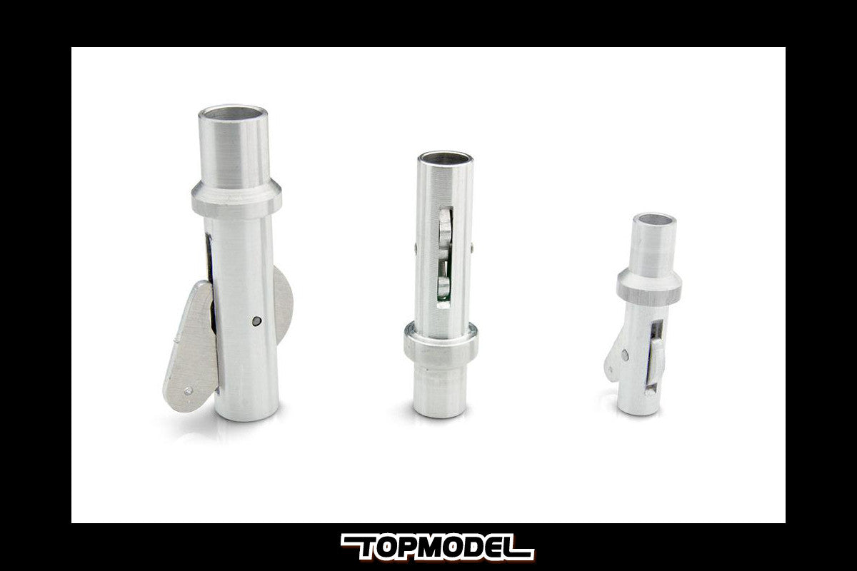

Finally thinking about getting to this build. My friend and i were talking about trying out some powered towing and i was thinking about putting one of your aerotow hooks in the nose. What do you think about that? And do you think the small one will fit?
Never used one myself, but have been selling them for years and never heard a peep back from folks, that is usually a very good sign. Yes, small should be fine.
I've used these a ton over the years and they work fine. They do take a little extra room for the pushrod to clear. Make sure the loop on the end of your tow line is sufficiently long to insert into the tube without the knot going inside, much easier to deal with that way.

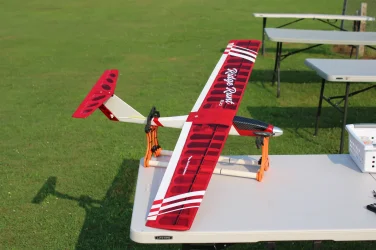

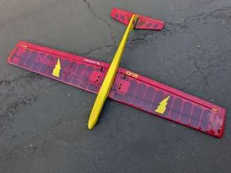

It finally lives!! Been done a month or so and finally got it out to fly. Maiden was a bit of a handful as it went vertical on the launch. CG ok but a bit out of trim. Video came out really blurry. Cruises around nicely at 20% power. Really loved the build guys, great fitting on all the laser work. Highly recommend getting one. Can't wait for the next project. Want that 100 incher next Wayne!!
Thanks again, Will

Looks really nice! Love it.
Next up will probably be the Lele, the idea with the LeLe was a little bigger and a little more complex, but turns out it is very easy to build also. LOL We may have some progress to show on that project late today.

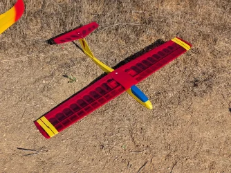

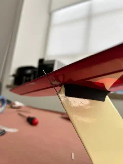

I finished mine and flew it last weekend. It flew good but it needed a ton of aileron trim. I was pretty careful to build the wing flat, but I didn't really check it again after covering it. Turns out it had a good amount of twist in either one or both of the panels. I heated them up and got them pretty straight. Flew it again yesterday, and while it wasn't quite in trim, it needed only half as much as before.

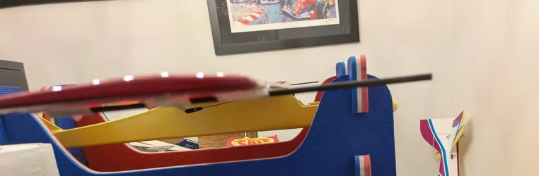

So, I checked it again, this time by taping some carbon fiber rods to the bottom of each wing tip, and sighting down the span to gauge the straightness. It was still a bit off, so heated and twisted again. I overshot by a tiny bit, but I think we should be good now!
Still need to add a bit more graphics, but that'll wait till I get it all trimmed out for good.

I like the carbon rod idea.
Anything light and straight will do. I had at first tried to use my incidence meter, but it's way to heavy to sit on the wing without the weight if it twisting the wing and throwing off the measurement.

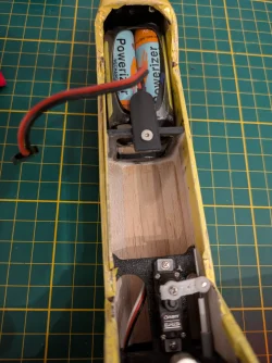

Since I'm old fashioned and still use NiMHs, I decided to make a former for the battery area and a little retention latch. Not so much because it's necessary, but more as an exercise in 3D printing.

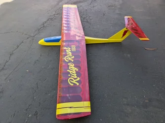

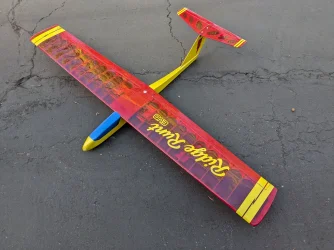

And we're done! Thanks to my friend for cutting out the logo from the same pearl yellow Ultracote I used on the fuselage.

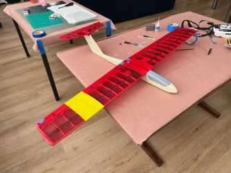

I'm getting close! It's been a nice build. I really like the 3D printed components, it seems to make things much easier. I just wish the covering stuck to it better.
Some questions below. Please let me know if this isn't the right place to ask.

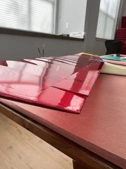

  1. I have a stubborn twist in one half of the wing. Any tips on getting it out? You can see the covering has curdled where I was blasting it to straighten it at one point. I plan on flying it as-is, but if there's a chance it can be fixed easily I'll try it.
  2. Any tips on creating bends at the right place for the linkages? Honestly, I would gladly pay an extra $10 for easier linkages. I'm afraid to just wing it, I've made mistakes before that caused my centering to be super off.
  3. How are you all widening the servo horn to make room for the piano wire? The control surface horn?
I'd love to hear any thoughts about any of these that you may have. I'm looking forward to getting this thing in the air.
