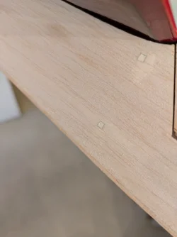

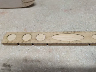

This is the trailing edge for a Carolina Customs Altezza. It's balsa with a pre-cut 64-in ply plate on the bottom. It's probably completely Overkill on the Alteza since it's a rudder elevator airplane (it's a modernized Sagitta 900) and it's really not needed. However, it is still quite light and I could imagine it working pretty good on the Runt's ailerons.

I'll be curious to know what you do. Meanwhile, I was able to cleanly separate the the ply from that TE, and I might repurpose it. It's actually 1/32", but it's still very light.

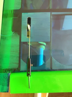

Here are a few photos.

Elevator:

The 90 degree bend at the elevator allows the tail to be removed easily. Please note the "reversed control horn" on the elevator.

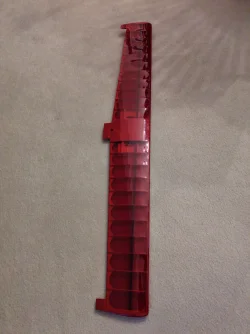

I finally got around to cover my wing. I'd say it came out pretty good. I used some hobby King covering that I had left over from an earlier project.
I did notice something that I was wondering might be addressed in future kits. The front of the wing only contacts the saddle on the spar and the leading edge. The covering between them just makes a straight line, so it does not conform to the saddle on the fuselage. Perhaps in the future a rib could be added here, or the print could be modified to include another rib in this area? I intend to fill this area on mine in the meantime.

Somehow I screwed up when I set the cut on the fuselage. That is on our to be fixed list. Sorry about that.

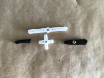

I wanted to have adjustable clevis somewhere on the elevator push rod however the space did not allow. First I tried the clevis that comes with the Dream flight Alula/Libelle and there just was not enough space for it to travel to the rear. I decided to use a Z-bend as Wayne recommended and discovered that the cross arm I thought to use was not long enough and caused a bend in the push rod so I used to long horn and cut it down. From left to right: Dream Flight small clevis (Alula.Libelle), long servo arm, cross servo arm, and Dream Flight large clevis (Ahi, Weasel).
I managed to get the elevator Z-bends adequate. I'll know more when I test fly it tomorrow however it looks to be trim-able. I used the large DF clevises for the ailerons.

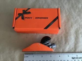

And I bought this $17 mini hand planer and tried it out. Never used one before. Worked very well especially on the aileron bevels.

For the elevator you use a simple 90 degree bend. This allows you to remove the elevator for transport. A Z-bend at the servo end works well. That's just me, I like Z bends. If you like, you can use a clevis or an EZ connector at the servo ends, but the bends are pretty darn easy and take up less space. I hate messing around with EZ connectors.
Hey Wayne I ended up using a Z bend + 90 degrees on my elevator as well however I misjudged and am at the limit of my trim tab to get her to fly level. I need to make an adjustment .Which end do you recommend I mess with? The Z bend or the 90?
