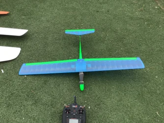

That seems to work just fine. I put three pieces of blue painter's tape in between the upper tail mount and the stab and the trim is a lot closer. I will add more if this is not good enough however it's a better solution than trying to re-bend the wire.
Thanks again!
Michael
PS: Photo at Torrey Pines (I was alone so no one to photograph me launching it for the first time) Sorry for the rubber bands my hatch magnet came loose. I have fixed it...

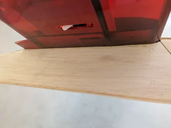

Here's how I ended up filling the wing saddle gaps. I used some strips of 1/16 balsa to widen the rails of the saddle a bit, then made a paste of wood glue and micro balloons as a filler. I put some packing tape on the wing bottom to protect it, then sat the wing in the saddle so that the paste would mold to it. I did this in three or four steps. I think it came out pretty good.

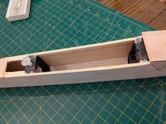

Oddly enough, we updated the side cuts and added a doubler this morning. Also refined the servo tray for use in either glider or electric versions.
We will update the plans and manual to show these changes soon.
