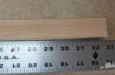

I just got the embiggened ailerons (thanks Wayne!). However, they do have quite a bit of span wise bowing in them. I had to sand the leading edges of the original 1" ailerons to get them to sit flat against the sub trailing edge of the wing, but these have quite a bit more bend. Before I take the sanding bar to them and losing more precious aileron chord length, does anyone have any other suggestions for getting them straightened out?

Konrad suggests:
But the best way to deal with the stresses released in the shaping of lumber is to cut the aileron at about the 1/3 cord point (Thick side). Preload the two pieces and heal with thin CA. Keeping the two pieces down on the glass (building board) and there shouldn't be too much need to finish sand.
We have had pretty good luck spraying a bit of alcohol onto the wood and letting them dry while held in the correct shape. Have not tried this with aileron stock though.
Balsa will often times have some stresses like this. Some of the 1/16" sheets can be pretty wild, but a bit of care and it is great. It can be 100% perfect when it leaves our shop, but by the time it ships to a customer it can be all out of whack. We ship on a flat of cardboard to reduce this, but simple humidity changes can cause this. No different than a 2x4 from the lumber yard.

How badly is your stock bowed? If you have a little time, I'd suggest pinning it out straight and let it rest. It will probably do the trick after a day or three.
That's what I'm doing now, but so far after 24 hours, I don't see much difference. I tried using alcohol, but I may switch to my old standby, amonia.
On one of the ailerons, I'd probably have to lose at least 1/16" or more to sand it straight.
I'd just glue some scrap balsa on to it and then sand it. It's not that big of a deal. Then again one could steam it then pin it as it dries. Is the width the same from one end to the other?

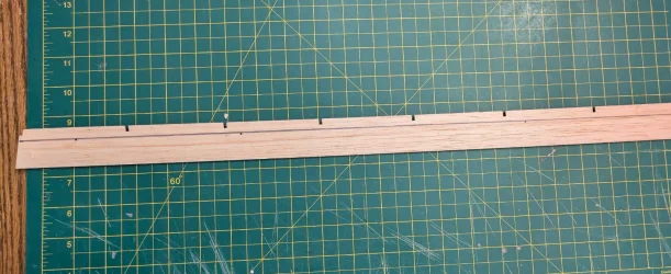

Just to see if I'm understanding this correctly...I've got this scrap piece of aileron stock that's roughly the same size as the 1.25" RRe stuff. I've marked a spanwise line 1/3 of the way out from the leading edge (the thick part). So, the next step is to cut it into two separate pieces along that line? Then take the first piece (the 1/3 part) and pin it straight to the board, removing any curvature. Next, pin the 2/3 piece to that, also removing any curve. Glue. Did I get that right?
Sorry to make this overly complicated. I might try it on this test piece first if I've got the steps correctly here.
No, don’t split it all the way,stop short say 1” from each end. Glue it, I like aliphatic resin (wood glue), to give you some time to clamp it flat between waxed paper.
