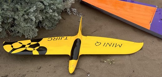

Well...... since you mentioned it...... I flew the Mini Q maiden for close to an hour on this first flight....about the time I was getting ready to land, I got a weird control hit, got it pointed into the wind and then.... the battery died and this beauty went full Elevon right, and spiraled at warp speed to the bottom of the dune.......
After a brisk hike down to the bottom, I found my bird nose into the sand on the side of the hill, and to my happy surprise, NO DAMAGE! Attached photo is after the death spiral...
Tough is correct! and this is an older model without the reinforcement...
Thanks again Wayne for all you do (Coaching manufacturers, suggesting improvements) to provide quality products for all of us sloping nut jobs!

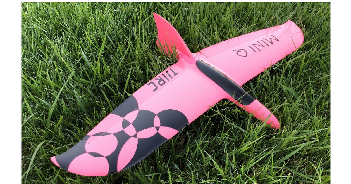

So... finally built two Mini Q kits I bought last year! (Life - and its alternative - got in the way...)
Learned a few lessons building the first one (Blue and Yellow), along with thoroughly reading this forum, and applied them to the second one (Pink and Black).
Maidened the blue one last Saturday at Four Corners with decent lift - needed minimal trimming with the CG at 20mm, but I suspect moving it back to 23mm will make it even better. May not get a chance 'til winds pick back up in the spring, though!
Took lots of photos and notes on the second build, and spent the last few evenings turning them into a detailed Build Doc (you know, like a construction manual, but more personal). I share a few tricks for quicker alignment and balancing, which I hope new builders will find useful.
It's a Google Doc, with comments enabled - always room for improvement:

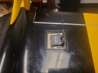

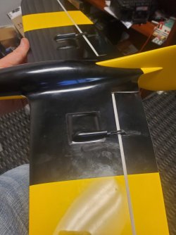

I am finally getting around to building the bird I bought almost 2 years ago and I had a design comment, however before I mention it I want to emphasize I am NOT much of a builder. My RC career has been mostly helicopters which are basically erector sets. With that out of the way...
Shouldn't the hole for the servo be lined up with the hinge, and if for some reason it cannot be, shouldn't the angle of the pushrod exit on the cover be perpendicularly aligned?
Yes, best practice is to align to the hinge. In this case the mismatch isn't too bad, but I would add a ball link to one end or the other of the pushrod. You can also rotate the servo to be perpendicular.
Usually you rotate the servo at the time of install to align with the hinge line.
What servo are you using there? I see you have already glued it into place, but if it is a cheapy servo, you may want to do the surgery and pull it out, you really want to put a high qaulity servo into this plane. Any play in the servo output will send this plane hunting in the sky.
My currently favorite servo is the FrSky Xact HV 5611. They have perfect centering and have a much better price than KST. (If you are using FrSky radio gear, they also pack a punch full of other features that may be useful.)
