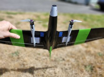

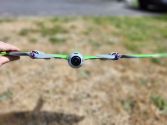

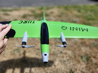

Greetings all.
Many thanks to all who've contributed to this knowledge base, it's been super helpful getting my MiniQ up and running. I was hugely inspired by omegooliebird's FPV version, but I wanted to see if I could keep the drag to a minimum. Feeding his powertrain into ecalc, I came up with a twin puller version that is fairly close to the stats for his plane.
Caddx Polar vtx
Twin T-motor F1507 2700kvs
APC 4.1x4.1 props
TBS Crossfire rx
KST X08 servos
3D printed nacelles and matching servo covers
JHEMCU Wing 40a 2-in-1 esc
Molicel P26 4s1p (rated for 35a)
no fc or stabilization
3mm reflex - will be setting this to 2-2.5
3mm elevator - seems perfect
8mm aileron - will dial this down a bit
AUW 608g (yeah, she's not light at all)
CG 21mm (was REALLY hard to hit this, added 12g lead)
Pulls 29a wide open (ecalc estimated 28a)
After a decade of flying foamies, this is my first composite plane and I'm incredibly impressed with the build quality. Can't wait to get it fully dialed in and ripping. Maiden flight was fairly uneventful, aside from the launch.
I did want to make one suggest for the next rev of the MiniQ: could you extend the nose another 2-3cm forward? That would lessen the amount of useless weight (lead) needed to hit CG by allowing it (and motor/battery) to sit further forward. It's just so tail heavy off the bat, this would allow for even lighter setups.

Very neat! I really like that.
CG works out much better with the motor and battery in the nose.. a lot depends on the motor being used.
I love this!! Great work! Particularly impressed with the idea of incorporating the servo / linkage covers in the nacelle. I had thought about a twin, but like you say the CG is very hard to achieve, even with the motor in the front. I also wonder if with some x06 servos, it would be possible to tilt the motors and make a twin rotor tail-sitter. Could be flown anywhere. These things do have a fairly shallow and fast glide slope with the weight of FPV and the 4x 18650 cells.
Thanks guys. This plane is an absolute ripper, super fun on flat days.
@omegooliebird you could definitely get away with a VTOL belly/tailsitter on this. Many years ago I converted a VAS Ghost to vectored tricopter, but honestly the new T1 VTOL is really close to where I ended up on the Ghost. The STLs on thingiverse should be easy to convert to the MiniQ airfoil.
BTW, @Wayne I'm the one who's been bugging you for the PCM Fritz. I've envisioned adding a low-profile FPV pod on top, I think it would handle amazingly well under the goggles. I'll definitely be picking up the lighter MiniQ when those land back in stock.
