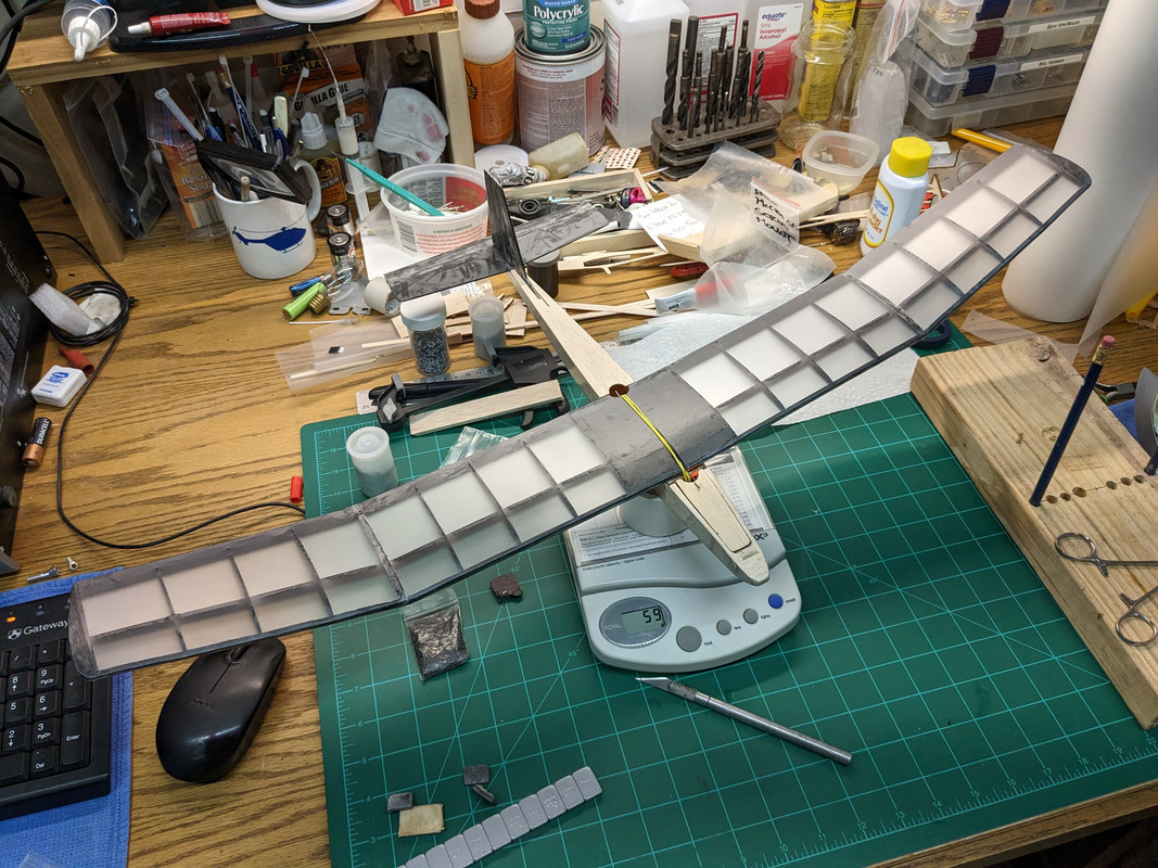

Got back from two weeks out of town. Just finished covering the other wing half, making servo/control horn connections and setting C.G.

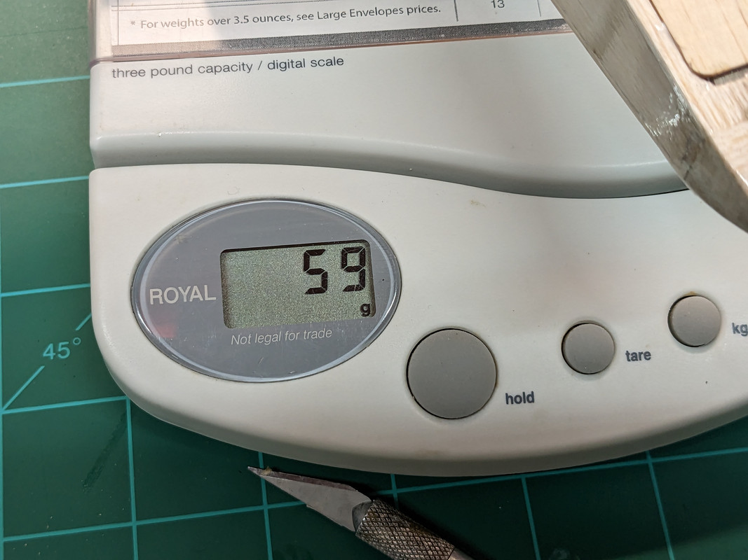

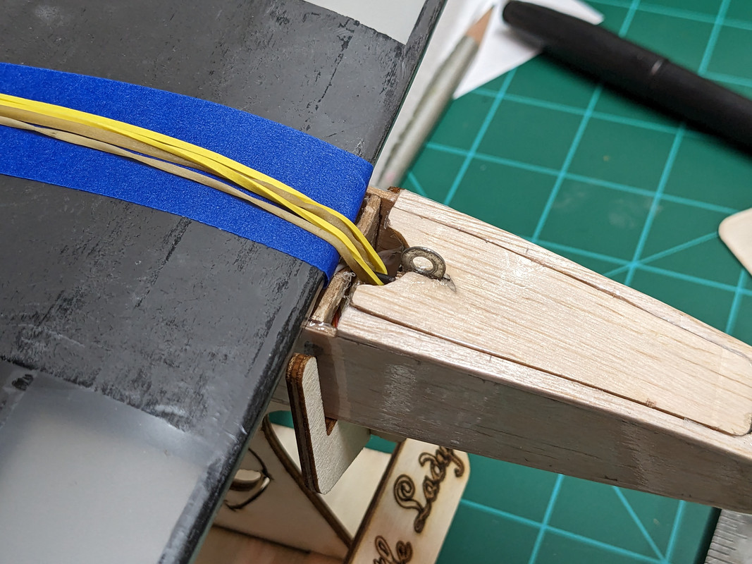

All Up Weight, with 15Gm of lead in the nose and the paper clip tow hook,, is 59Gm. Hmmmm, may end with a tad more after I add something to cover the center-line, between the rubber band and the wing.
I used 1 Mil laminating film on the wings and tail empenage; 1.5 Mil L.F. on the body. For reference, the 1 mil laminating film weight appears to come out to about 22Gm/Sq. Meter (a 30x30cm piece weighed 2Gm.)

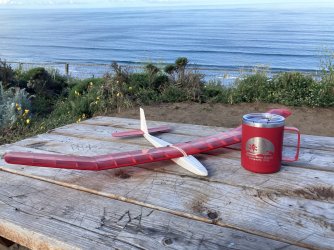

Had my first full flight with the Micro GL. Flew GREAT! Didn't even fold the wings with a loop. <grin> Winds at Bluff Park were in the 8-10MPH range, so it was a little bumpy, but it got some great altitude.
