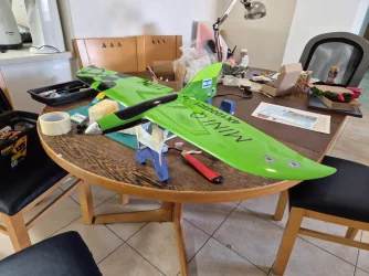

Balanced at 23mm. So when I add the propellor blades I'll be ever so slightly nose heavy. Good enough for the maiden. Hopefully next week Friday...
Don't mess with the CG - nail it. These planes are not very tolerant of the CG being off more than about 2mm.
Maiden went great, but she was very squirrelly! After a few circuits I landed, and moved the battery 2mm forwards, lowered the rates, and increased the Expo (which stood at 0%...)
By now the wind had picked up, and was much stronger, with serious gusts. A very short flight, just to make sure we had it right. Seemed much better now, but we'll try again when the wind is more agreeable.
Definitely not underpowered, even on a 3S setup. Launched at 3/4 throttle and never needed more!

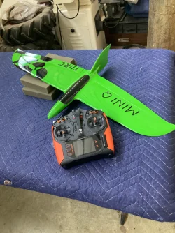

Just started flying my mini Q. Super fun on the slope. Used kst 08h for little extra torque. Threw in elevator compensation on throttle stick to trim at speed. Otherwise the faster it fly’s the more it pulls up on its own. This substantially increases speed envelope. Came out 12.8 oz. The tail is fragile especially on landing. Work and trim to get a proper fit then reinforce top and bottom with clear packing tape where it meets fuse. Great fun and reasonable price. There are a bunch of them flying at The Point of the Mountain in Utah. Super fun with a gaggle of them ripping around. Ted

Excellent. Interesting about the speed pull up. If anyone needs a new tail, just let me know, we can order some in.
Has anyone made a replacement tail fin from correx to reduce back end weight of you did how did it fly?
Many thanks rct
Not that I am aware of. It flies great with the stock tail. She builds out to a good weight for this model.

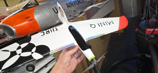

Got mine ready to maiden. Thanks for the CG and reflex values! Mines in at 305g bare/505g with 4s3000 JP30, 6s Talon35A, Newbee 2306.5/1850kv on APC 6x5.5. 30A@425W and hovers 15min at 50% throttle. 900g thrust. 2650mA used.
When she's needing more oomph.... drop in a 6s550hv and put on a 5x6.5 prop....435g AUW and 900w for @4:1 thrust. Crazy, but only @400mA capacity to play with...meh
Nice setup! In my experience, the miniq is so slippery, it doesn't need 6 inch of diameter to grip, it is happy with 5 inch... APC do a 5x7.5, which will give a lot more speed with similar amps as the 6x5.5.
