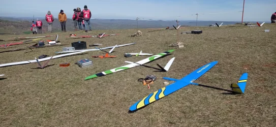

Love the Mini Q at an F3F race.

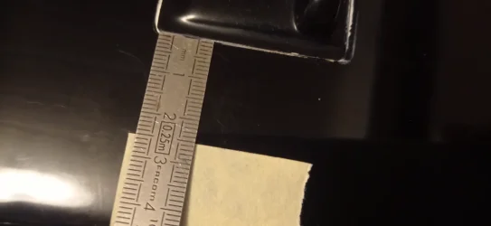

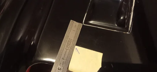

CG is not easy to find and the problem is when people speak about the ajustment from the leading edge:eek::eek:. the axial distance is not the same depending where you take mesurment along the wingspan! Personaly my CG is 25mm from the servo acess door edge. i put a peace of tipe parallèle to the edge (meanig perpendicular to the fuselage axis and not parallele to the leading edge). Hope this info will hlep people for the CG ajustment. Best regards

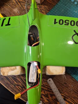

I have just received my MiniQ glider. As note in earlier posts, the servo well is positioned so that the pushrod will be parallel to the flight direction. However, the wing is swepped slightly forward, so the elevon hinge is not at 90 degrees with the flight direction.
If I install the servo square inside the well, the pushrod will be at a small angle with the elevon hinge line. Would that be a potential problem?
I could ofcourse install the servo at an angle in the well so the pushrod will be at a 90 degrees angle with the elevon line, but not parallel with the flight direction...
Any thoughts on this? Or am I overthinking too much?

Either option is valid. The Mini Q does not need a lot of throw, so the linkage being off angle a bit from the hinge line is not a big issue. And if you decide to keep the linkage square to the hinge line, the drag penalty is probably so small that it can't be noticed.
I ran my linkages parallel to the fuse, and put ball joints on the control surface hinges to handle the offset angle. Worked well.

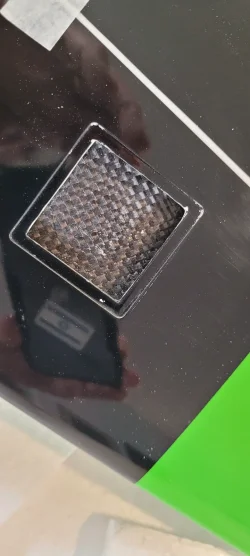

Ok, so I've learned the CG should be around 23mm from the LE at the root. Now, what do you guys do with the antennas? Is there carbon in the wing?
