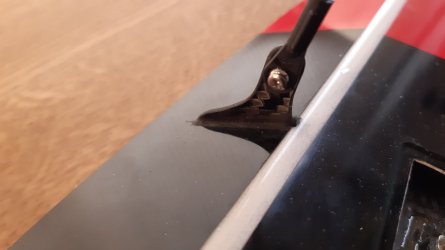

Yes, with supplied bulged servo covers.
The A10 is a much better fit and can use cleaner flat servo covers.

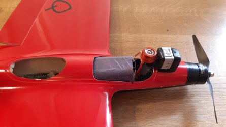

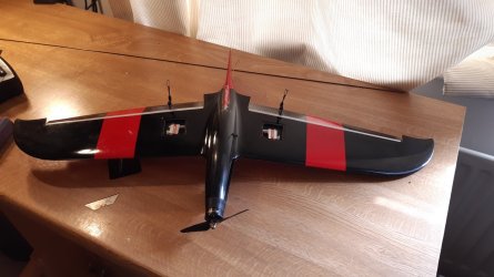

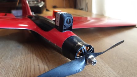

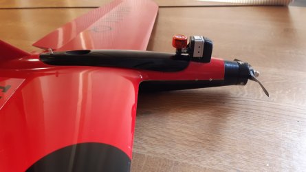

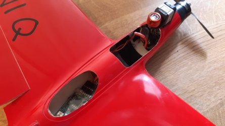

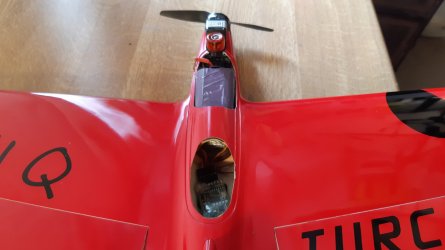

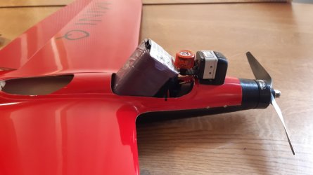

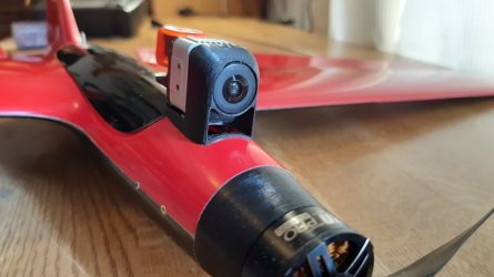

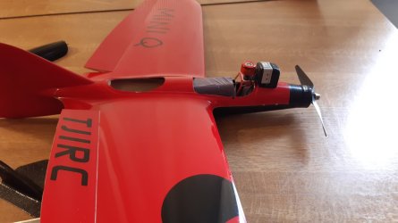

Here is my Mini-Q FPV. Thanks for the info on here, it helped me to make the maiden go well! It is a little ripper! ... like an angry wasp!
No flight controller or GPS in this build
DJI / Caddix HD camera and Vtx
20a Little Bee ESC
3A Amazon BEC
EZUHF with dipole antenna in the fin

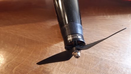

T-motor F80 1900kv
4s1p LG-HG2 cells
5.25x6.25 APC prop

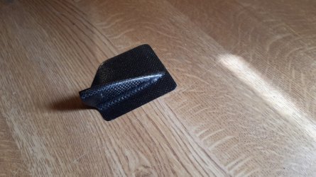

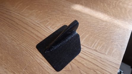

Home made servo covers, wet lay carbon vacuumed over a 3d printed pattern

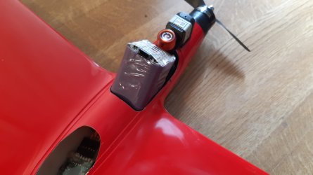

3D printed camera holder
3D printed Caddix VTX holder
3D printed KST X08 servo trays (with m2 nuts melted into them)

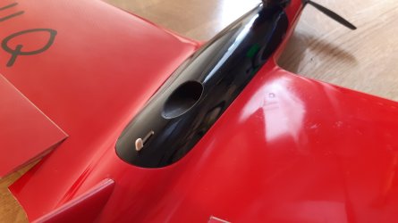

3d printed motor mount extension with cooling
There is a cooling hole for the VTX below the camera lens, this scoops air straight on to the top of the Caddix VTX. The motor mount has air passages, so the air goes onto the ESC from there. It stays cool enough.

The FPV speed record (unofficial) is currently 509kmh with my electric 14s Vasa Fusion and closely followed by the same plane with a turbine on it at 502kmh. I'm pretty sure the Mini-Q would be good for 400kmh+, in terms of drag and internal space. I may build another for LOS and see how fast it can go! CG was everything on this build though, I had to get everything as far forward as possible and had to extend the nose. It must have to be heavy as a glider just to get it to balance. Mine comes in at around 500g. I launch from the wingtip and it goes away like it's on a bit of string! So easy! Landings are a bit squirmy as it slows down, not having rudder, makes staying on centre quite hard.
Over all this is one of the best platforms I have flown in nearly 10 years of FPV. it is just so accurate. Having nice servos really helps, but the airframe / aerofoil on a plank has to be right for it to fly like this!
