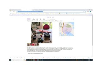

Hmm, looks to be one of our customers, but a bit confused by the listing.
