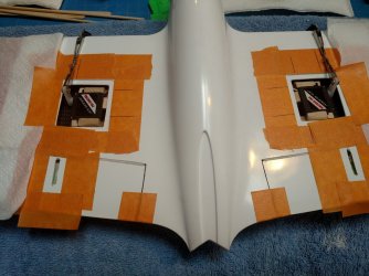

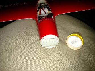

  • control horns - make a slot thru surface and epoxy the horn with a nice fillet.
  • servo attachment - I have friends who just epoxied the servos in place after roughen the surface. Since I put cheep servos in mine I made them removable with some ply + hard wood..
  • bulkhead - Do use one - it will make the nose stronger. I made one from ply so that I could set it back about 1/4" into the fuse and use the space as a 'compartment' for my weights.
  • nose cone - I tape mine on. Make dialing the CG a lot easier.
  • tail - at first I had a little epoxy on it. Big mistake. First harder landing it cracked the fin and fuse. Now it's friction held (pretty tight) and if we land hard hopefully it will just pop off.
