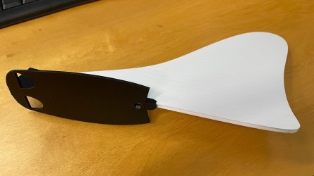

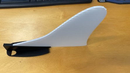

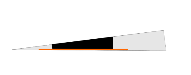

So here is what I came up with.. It is a simple to install fin box. A single #6 sheet metal screw locks the 4mm coroplast vertical in place. A pilot can use the finger holes on the bottom, or put their fingers at the trailing edge. Both are protected via the fin box. (builder removes some foam for the bottom fin box)
Will test fit one very soon, if all is good will be on the site VERY soon.
The fin boxes Nate uses on the StarFire work great. They slip in easy and hold really well. He even printed them for the 24” version I had last year and they also work well.
Yes, I have always liked his fin boxes! I think this is pretty similar?
The screw in the rear is not really needed, the 4mm coroplast is a snug fit. Works really well. Need to open up the finger holes a little, and probably pull some weight from the 3D print.
