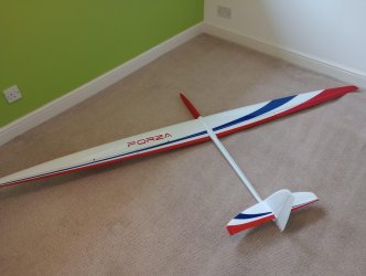

I’m the proud owner of a Forza kit and am about to start building her. Really love the colour scheme and the build quality looks good so far.
I may need some assistance along the way….
Here she is:

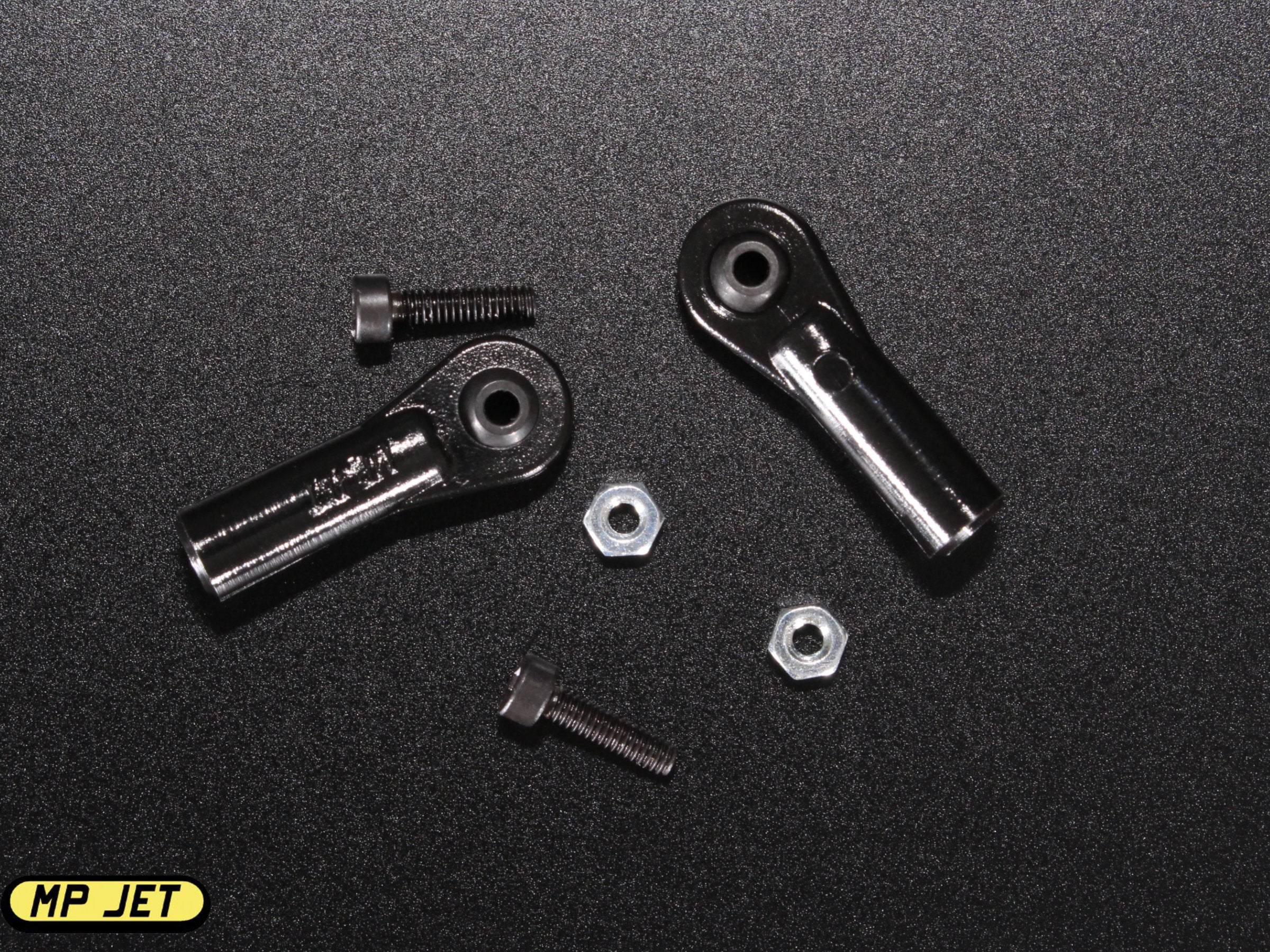

Can you recommend a suitable ball link for the elevator connection, as there isn’t one in the accessories bag? I’m going to fit 2x X08H in the fin.
I ordered these MP Jet ones from Neil, but they dont look correct. I could cut the brass ball down and drill out for the 2mm elevator link rod, I guess but if there’s a ready to go option, that would be better.
Martin
If the rod is 2mm, here is the correct animal:
The MPJ part number is: mpj_2332_B (Neil should have this and be faster shipping for you.)
The linkage he supplied you might be OK for the servo end.
You really do want ball links, and you need a way to capture the ball link on the elevator so it can not slide side to side. I'd love to see a better solution provided in thee kits. This is the only annoying part of the build IMHO. Rest is normal.
Martin
Sorry, Martin—this is an omission by us. Yes, the ball should have a well-fitting socket and a 2mm hole. It's actually soldered on to the rod, which I normally leave in the model on disassembly. The ones that Wayne has shown will be great.
