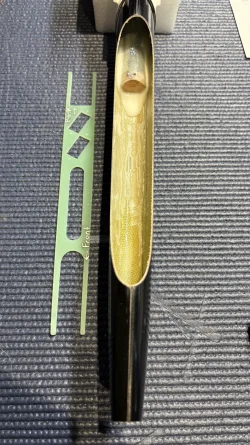

Hi Guys,

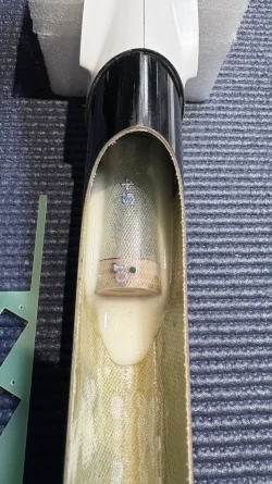

Just a quick question which will help me along with the placement of my fuz ballast tube and servo tray. Is it intended that the servo tray and ballast tube meet together in the same way as I have placed them together in this picture? Is this best practice? If so that’s great and will help with the degree of sanding on my servo tray… ( Geez, the servo tray is tough as nails on my sander blocks). Would anyone be able to post pics of the insides of their fuz?

You have to place the ballast tube in a position that will put the center of ballast in the 100mm CG position. If there is enough tube to fit into the slot then great
Hi Myles,

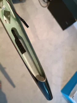

Here’s a photo of my tube / servo tray installation. As James says, get the tube in the correct position for 100mm cg and the tray then goes back to help support it. I trimmed the tray to give a nice snug contact with the inside of the fuz and then used slow epoxy to fix it well in place. The tray adds loads of extra strength to the fuz, so spend a bit of time to get it fitting nicely.
Hope this helps, martin
P.s. from your photo it’s looking good, but remember the tube position is the most important and the rest follows from that.

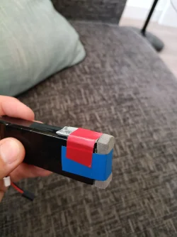

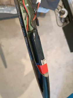

I had to open up the battery slot in my tray for the 1600mah LIFE pack and added a tab of Velcro to keep it in place.
Seems to work nicely :-)

At the front of the LIFE pack, some hard foam for cushioning…. Just in case :rolleyes:
The taped on lead on the battery pack and behind the lead slug are for cg trimming at the slope.

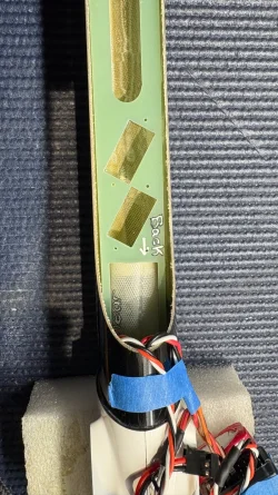

Well I may be somewhat geographically isolated here ‘Down Under’ but the wind never fails and mail never fails :)

Regarding the weight issue…
It’s a balance between toughness and weight and I think the std layup is about right. Assuming the weight is used to create extra strength in the right places and not just heaviness :)
