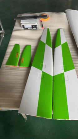

The Toccata front end - note the nicely shaped Phil Brace-designed canopy, and the much beefier wing joiner.
