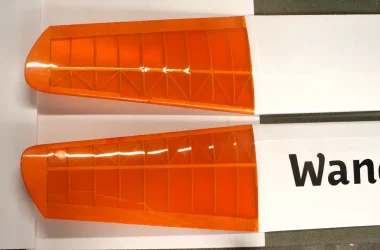

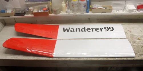

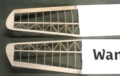

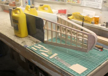

2. Install diagonal braces between the spars an the leading edges.
Diagonals installed and tips re-covered with Top Flite MonoKote.
Ready to fly to see if we chased away the howling, soon as we get suitable weather.

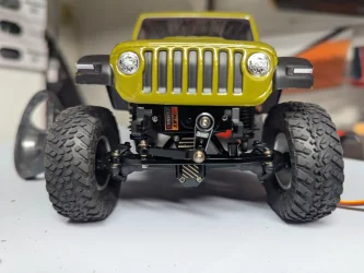

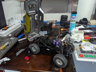

Spent some time this weekend, while waiting for glue to dry, to tear apart my SCX24. First time working on a rc car, was a little intimidating at first, but than i ended up having fun.
Completely replaced the baby brushed motor with a brushless and new metal transmission:
New servo, metal steering linkages, metal covers in different areas (trying to drop center of gravity and give it some weight), wheel extensions, and i put in some -33% gears in the back axle.
I ordered new tires but forgot to order wheels so waiting on that.
PXL_20250414_143244593.webpPXL_20250414_143157201.webpPXL_20250414_143145081.webp813503f5-e6e9-4d99-be8d-7ae46c743f04.webp
