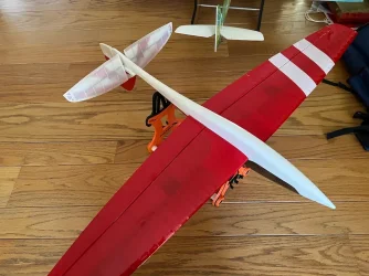

Just weighed my ahi at 340g, so can I assume this would need a bit more air than I'm used to with the foamy?
No, not necessarily.
The Ahi is moulded from foam, so although it's very light (Max weight 425g), it does not have the best aerodynamic performance due to thicker TE's and surface finish and design topography (Non-smoothed bits).
Even made from balsa and with a film covering the overall drag from an Aria will be a lot less than that from an Ahi.
This will be easy to see in the Aria's better accuracy of manoeuvres, penetration and overall energy retention when compared to its foam counterpart. Ballast of a kind can also be used by changing the round wing joiner.

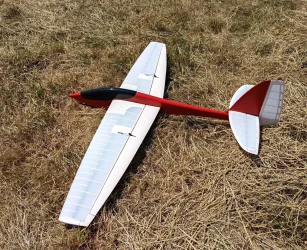

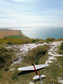

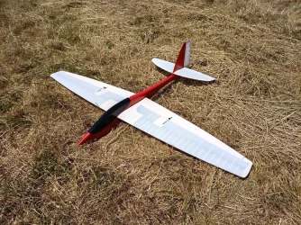

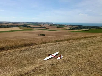

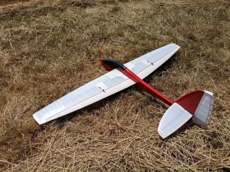

Martin Hyde maidened his beautifully built Aria at Cap Blanc-Nez, France. She flies well. It's nice to see my balsa designs being enjoyed - great kudos to Andy at AngelWings designs, who produces the kit.
