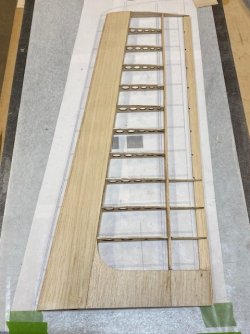

Some more progress. This is definitely the beta build of the wing. More tweaks need to be made. My estimate is with the aileron bits and the laminated and sanded wing tip one wing panel will weigh about 23 grams or so, uncovered. It is beginning to look 70's-ish with the sheeting.
It is looking really nice! Makes me want to make a wood wing for the Trix.
