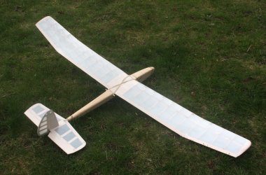

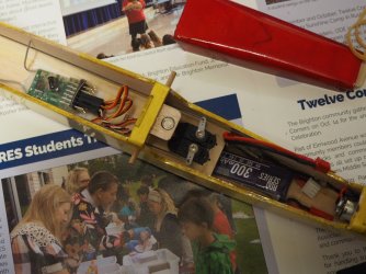

Mine came up a little heavy, 159g with 300mAh 2S battery, and this is the only battery It can get balanced with.
Wing feels solid, very. Also feels pretty, - the whole glider, that is.
That is pretty indeed. Love the internal colors. Is the balsa inside the covering painted?
Unfortunately, balsa is painted with not so good marker, which shows. The perfect ones I found already after covering was done.
JOT permanent markers. In $Tree store.
Will use them in future projects.

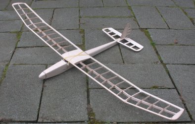

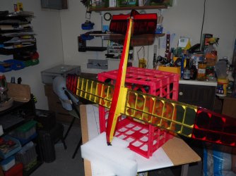

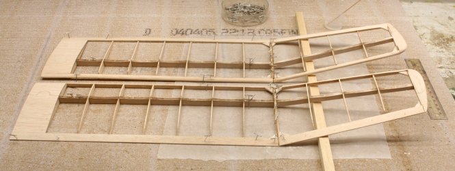

Making progress on my build.
> Nobody built two right nor two left wings so far?!
Not me. Not this time. <vlg>
'Tho that does not apply to all my builds.

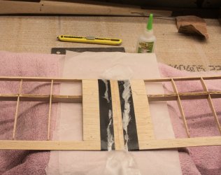

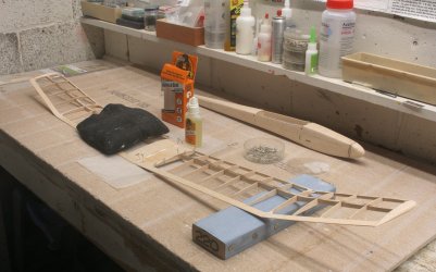

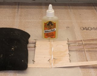

JOINED THE WING HALVES
Decided to join them with Gorilla Glue (PU - polyurethane).
- Lighter than epoxy.
- Stronger than wood glue or CA.
- Soaks into grain, and foam-expands to fill the gap.
- Easier cleanup (with a blade) than epoxy or CA.
'Tho next time might use regular (tan) Gorilla Glue because it sands better than White Gorilla Glue.
White Gorilla Glue dries quicker than tan, but ends up a little rubbery. Good for foamies, less good for woodies.
Wing join seam strengthener: 1/2 inch wide strip of 3/4 ounce fiberglass cloth top and bottom.
Laid down "on the bias" as the quilters call it - 45 degree angle, gives twice the number of fibers crossing the seam.
Applied with CA.
Black electrical tape helps to limit the final width of the fiberglass strip.

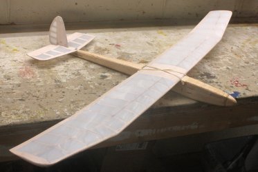

The model really looks the part of a 1970s WANDERER.
Yay-o-yay.

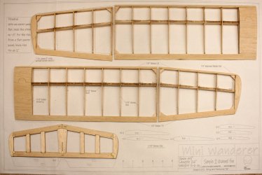

4. FULL SIZE DRAWINGS. I love working over full size drawings. Feels like old times.
5. CALL-OUTS on the DRAWINGS. Useful call-outs, again, like the good old days.
