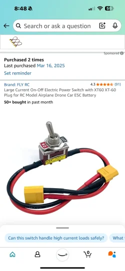

I have the x14 and like it very much. However if you can move up to the x20 the touch screen is more intuitive. Also most of the youtube help videos seem to be based on the x20. One tip on binding the receiver. Get an on off switch like shown in the pics. Otherwise you will be trying to hold down that tiny button and wrestling with the plug in connections at the same time. Double check all the plug connections to see if they are all the same. Jarron was great and soldered on xt60 battery connections so it was all compatible. Expect some frustration with the modern electronics. Just focus on learning one thing at a time. Welcome back. You will enjoy it.
