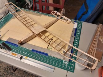

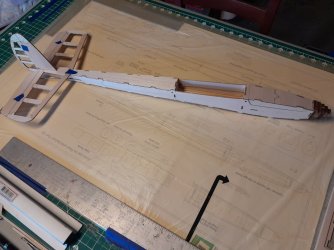

I picked up my kit last week at the store (all parts accounted for) and after about two hours of set up and building the fuse and tails parts are framed up.
Everything goes together very well. I am using square and corner stock for reinforcement and to aid with corner sanding. The little hatch magnet and pre-drilled cables guides are nice details for this well thought out kit.
Onto the wings, then sanding, gear placement and covering before final setup.
I haven't covered a framed up wing in ages, so this should be interesting.

Use light covering and don't shrink too much until it is all covered. You won't have any issues,
Bring it over Friday for build night and do your covering then. :) Just be sure to bring us some pizza. :love:
Red,
I plan to use Flying Film from Aloft
Wayne,
Good idea. What time does build night start? How many usually attend?
