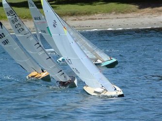

Any specific protocol I should avoid.?
Is there an 8 channel, one can recommend ?
It’s going in a Santa Barbra that is a fairly large RC sail boat that is one of the largest racing classes in the AMYA. It can use up to 7 channels.
