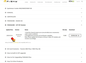

V1 firmware is available on the same download page. (although it is somewhat hidden) see image below
Here is a direct download link for V1 firmware XJT-Ver170317.zip

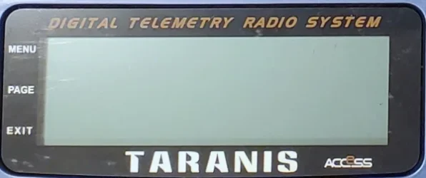

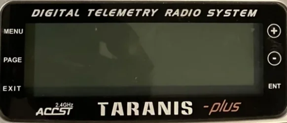

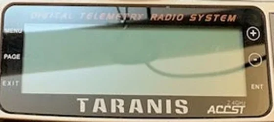

Are you sure you have a Taranis X9D Plus?
There are three main versions of these radios requiring different firmware?
There is an X9D, X9D+, and X9D+ 2019
You can usually tell by looking what is listed under the LCD screen.
If ACCST is just listed it's an original "X9D"
If plus is also shown it's a "X9D+"
If ACCeSS is listed it's a "X9D+ 2019" with an ISRM internal module. This one will not transmit the D8 protocol.
Hope this helps - Rich

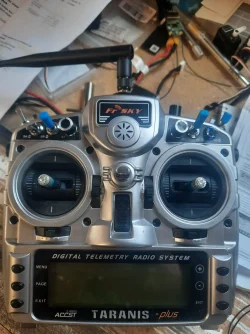

Yup, got the ACCST X9D -plus
That should make no difference. The Plus SE is still the same basic radio with a few additional options.
Your radio appears to be the X9D+ that someone added a removable antenna. (you have the standard gimbals, the SE has hall gimbals)
You can't update the internal module from the bootloader screen as this is only to update the OpenTX firmware.
You have to start the radio, long press the MENU button, page to the next page, select the "FIRMWARE" folder, use the minus or plus buttons to get to the "XJT_ACCST_2.1.0_FCC.frk" V2 file or the "XJT-Ver170317.frk" V1 file, then long press ENT key and select "Flash internal module".
