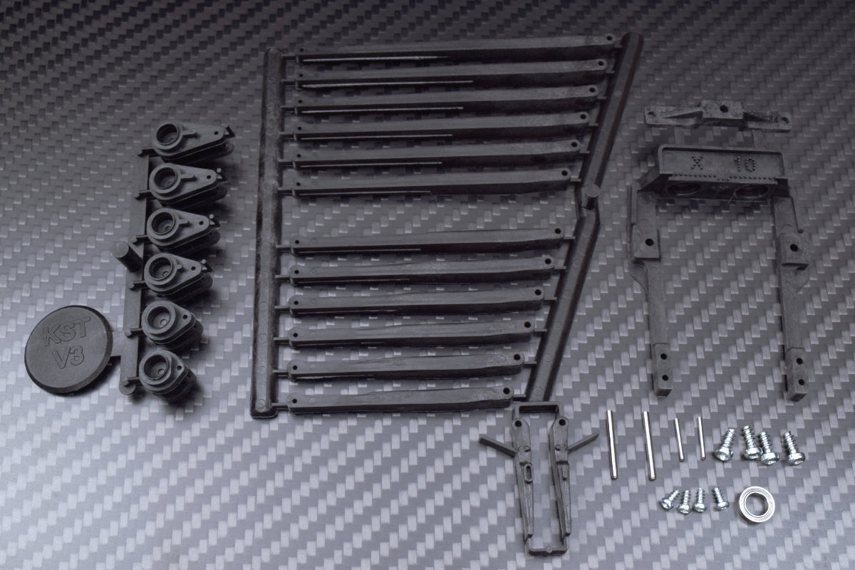

Thanks for the video on the lDS system set up. For that sizing when looking at the kit for the X10mini it asks for 2 sizes. and not sure what that sizing refers to. was guessing push rod length but not sure of the second. If I went with the x10 mini and A08 what lDS kit would I need to select?
Great that you have experienced help. With slope flying it will take some getting use to the idea that the elevator doesn't make the model go up rather the elevator controls speed.
I'm still not sure about your IDS size question. The Servorahmen IDS can fit both the 30mm long X-10 mini and the 35mm long X-10.

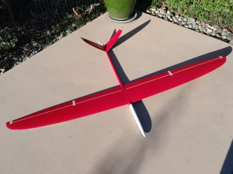

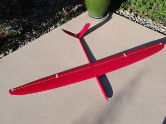

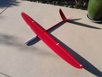

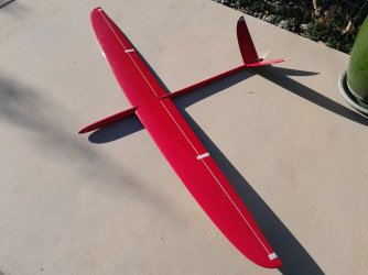

Custom colors thanks to Aloft's excellent customer service. The white nose cone is from my Tracer #1, which still needs a maiden flight.

Yeah, I like the white nose cone. Can order one in if you like, but probably easier to just spray yours.
