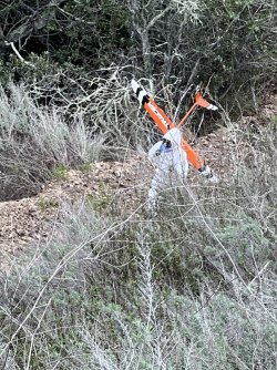

Side note: My tracer is laying in the bushes(poison oak) on the backside somewhere! I did laps for at least 4 hours a few days ago when the South came in and my eyes kinda got weird on me by the end and down I went. Im gonna head up tomorrow or the next day to find it. It made a loud cracking noise when I lost sight so.....
should be cool this time a year!

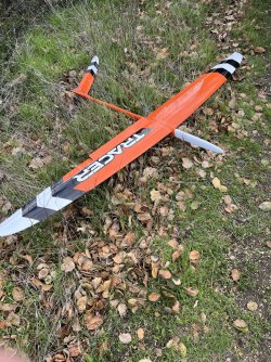

Wow!! Good deal,looks like it is in very good condition. How is the brush buster doing?
It's ALIVE!!! It has a couple little tiny cracks on the leading edge but looks pretty good. I'm beat though! It might not look like much in the pic but it wore me out.

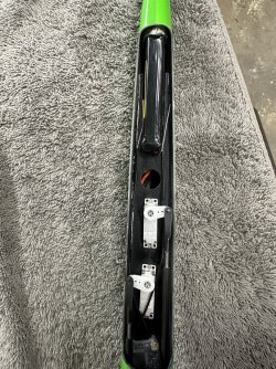

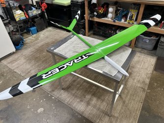

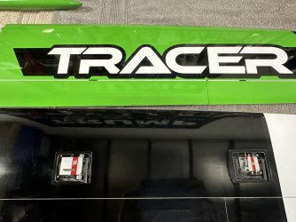

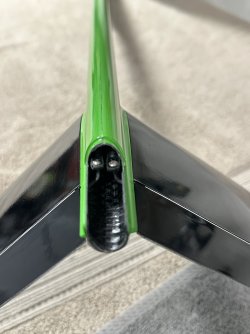

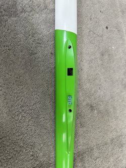

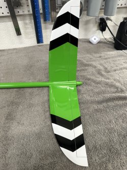

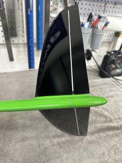

It’s been a few years since posting on alofts forums I have been reluctant because of a certain individual, he has either been banished or found better use of his time. Now that I got that out of the way this Tracer sure seems to be a sweet little ship and I can’t wait to get it up in the air. The fit is great and seems pretty stiff all around. I tried keeping it as clean as possible. IDS for the wings, zepsus power switch, G10 fuse support plate. X10s for the flaps and X08 for the ailerons and elevator. That flaps were a pain in the butt, I should have used X10 minis or just stuck with X08’s all around. I originally made 3 different molded nose weights out of lead and every time I was short on space by just a little. I ended up buying a couple pounds of tungsten #9 shot at $50 a pound (most expensive nose weight I have ever bought) mixed it with some epoxy and problem solved.

I never use any of the supplied hardware from TJRIC. I sweated off the balls on the supplied elevator arms and soldered on new ball links from DU-Bro. Did a little filling on the plastic to make more room. Its more than strong enough for the frontside flying I will be doing with it. Hope to maiden this weekend.

Nice, clean build. How did you install the tail units without cutting into the fuse?
I don't ever plan on shipping or selling the glider so the tails are glued into place from the inside at the main joining carbon rods with CA. I epoxied the v-tail hardware in place after the tails were permanently fixed. I have more than enough travel up and down without any rubbing on the fuse.

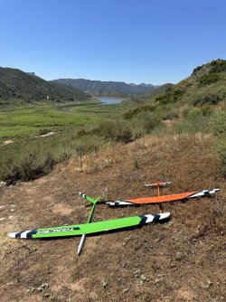

Maiden the Tracer in 10-15mph wind today. Required no trimming in the air. Elevator was a tad sensitive with the dual rates I preset into my transmitter, easy fix. On the landing I floated it straight down from about 15’, probably one of the best landing I have ever had on a maiden. The glider was ripping even in the light winds, looking forward to more wind and some ballast. Got to fly its little brother Magnus as well, left the big brother Alpha 2.8 at home.
