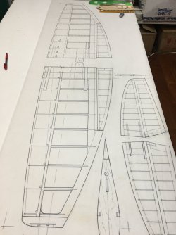

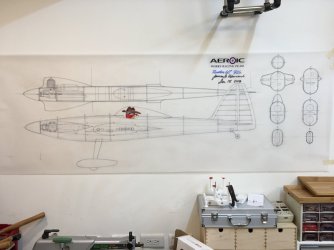

Hi Lads - I am taking a break from designing gliders and I'm doing a control line F2b stunt model - of my own design needless to say.
Thing is I have been away fro it for so long I'm out of touch.
Soooo...can any of you more knowledgeable chaps point me ago a good clear coat fuel proofer? I'll be using 10% nitro so it needs to be a good one.
Any help grateful received!
Couple of pics of the drawings etc below.
Cheers and thanks - Doc J.
