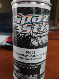

A couple of clear coat paints that are advertised to be fuel proof and are available to me at local hobby stores are:
Spaz Stix acrylic enamel spray can for RC cars. The other is a water based product by Deluxe Materials (I can't remember the product name).

Hank. Can you post a shot of the can on the first Spaz Stix?
I'm assuming solvent based?

After digging around for the Deluxe Materials Aerokote fuel proofer, I found out that it is only available in England, where it is produced. So l might look into catalyzed automotive clearcoat paint if the Spaz Stix spray doesn't do the job.
