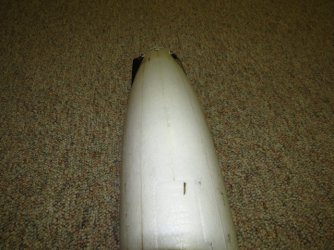

I'm going to take a picture of my Lentus belly after approx. 100 flights. Our field is more rough weeds than grass. Sure it has some scratches on it but it's held up really well. Unlike Konrad, I tend to land very smoothly at a minimum sink rate with wings level and a short "roll out" so my Lentus is relatively unscathed :)

As promised.. Lentus belly pic after approx. 100 flights.. Rough weeds for landing area but it is mowed short regularly. All I've done is add a few extra strips of clear tape on either side of the protective film included w/ the kit as I didn't think the strip was quite wide enough
