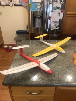

I went to the RC and sport Expo today. MrMPX was there. I didn’t have the funds for a Heron or Lentus but I bought two of these mini Solius gliders. These are great little chuck gliders. Great for playing catch between two people or just throwing really hard trying to it to loop. Could be made RC but not sure it would be worth it.
