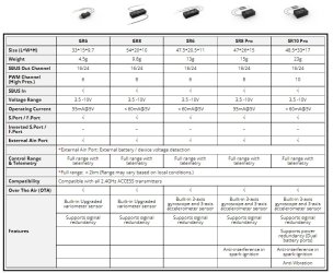

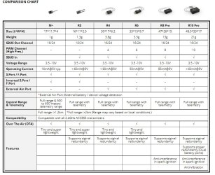

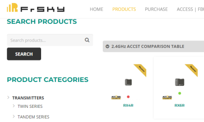

do you mean something like this
(first chart is for Accst, second and third is for Access, from frsky_rc.com homepage)
That's the link for Access receivers: https://www.frsky-rc.com/frsky-archer-series-access-receivers-release/
And you get Accst if you click on "2.4GHz Accst Comparison Table" at the top of the Accst receiver list.
