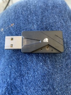

F8E78F54-2999-4757-BE4F-57AA639EAC2E.jpegJust making sure we are talking about the same thing. XSR-SIM. If so it only has a USB plug. I do everything through the USB port on my PC. Not dense just confused.
You take the plastic cover off to access the connection point for flashing. Hopefully this attachment worked! You can see in the picture the three holes, one marked ground, one marked 5 volt and one marked s port. You connect to that and flash it as you would a receiver. I thought as you do that you should be able to plug it into a USB port on your computer and just download to it. I found out you cannot.
Thx, I will have to see if I can upgrade it using the Airlink. My X12S doesn't have S port. also not recommended to use pins in module bay.
