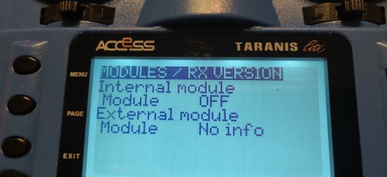

X9 Lite with XJT Lite, no power on module.

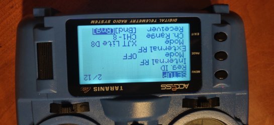

It looks like you are making the same error I made.
The "Mode" you have set is "XJT D8".
If you scroll a bit further, you will find "XJT Lite". I believe it is the last option. Once selected, you can choose D*.
I don't know if that will fix the issue, but it is the correct way to set up your transmitter.
My radio does not have XJT lite as an option but if yours does and I think worth a try on yours.
My led on module lights up after beep when selecting XJT D8 and binds with receivers.

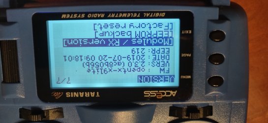

Here's my setup...
Sorry pictures are upside down.
I don't get a beep after selecting D8, but I do get repeti beeps after hitting the bind key.

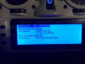

The information thing is only for ACCESS modules, won't populate with ACCST and 3rd party ones.
Found my module again and... yes it works on XJT Lite. Damn, had completely forgotten it was using serial and needed a dedicated choice...
So yeah, I guess the mystery of the non-working XJT Lites is solved...
