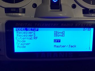

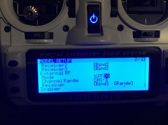

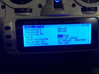

Is external module turned on and XJT selected?
Maybe I should ask what modules are there to choose from when selecting external module?
A picture may be helpful.
Here’s pictures from my 9XD but xlitepro was very similar
