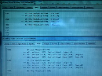

I have both planes working now but with very different mix setups.
Here’s a picture of the two setups:
Did you run the Lua script and set the wing type to delta in both?
