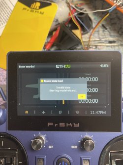

When I powered on my new x20s the models I had programmed were gone. What caused this? Guess I start over but I hesitate if all can be lost again. What do I do now?

Since model files are stored on the SD card, this may indicate a faulty card. I replaced mine with a SanDisk industrial grade card on day one, just in case.
You can back up your models by accessing the SD card and save the folder called models. I save the entire SD card contents just to be sure. When you access the SD card using the USB cable make sure you un-install the SD card on your PC before removing the USB cable. Also don't remove the SD card while your radio is powered up.

Probably a dumb question but have you looked at the SD card to see what is on it? "Invalid data" sounds like it could be that format change from one version to another? Had you updated the firmware version?

Thanks, that is the direction I have been going. Do you know what format to use on the new sd card?

I think a new sd card has solved the problem so far. Now if I can get the special functions to find the audio files that is the next ??
