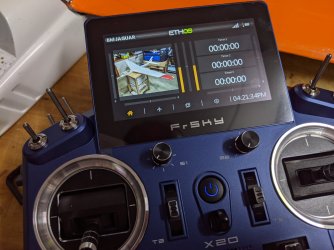

So you need png not bmp for image files. But man they look great.
