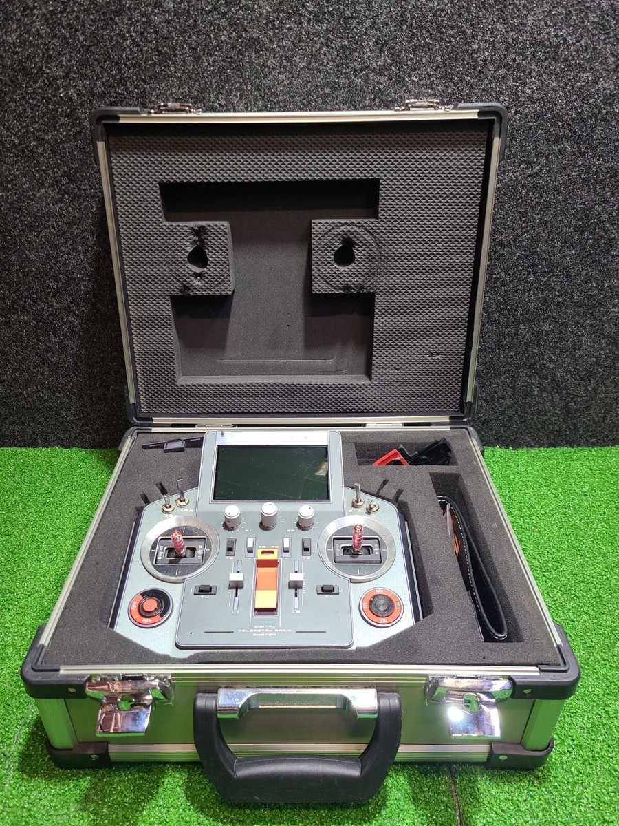

And the fancy case:
Just so you know, the cases are nice, the radios can not be flown, they are not safe and there is no firmware for them. $40 for the case, radio free. They have a lot of higher end salvagable parts.
Did you want us to ship to you, or hold off till the next time we see one another? These radios weigh, well, alot. Probably $15 to ship. Maybe more.
