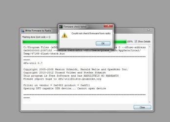

There is nothing on the back of the radio. I did get another computer to recognize that something is plugged in ... just not sure how to proceed now that I got that far.
After plugging it into the new computer, trying to read the firmware and models, I get the following error messages.
Any suggestions?

I think we are in agreement that something has gone wrong, and the wrong bootloader and or firmware have been injected into the radio. So trying to read what it there is of no value. Assume it is bad, and replace it with the CORRECT version. Triple check your settings in Companion and brun the correct data into the radio with the power turned off on the radio. This will replace the firmware and the bootloader.
Anyone else reading this, please let me know if anything stated above is not correct.. I have been away from Companion for a few years now and may be getting rusty.

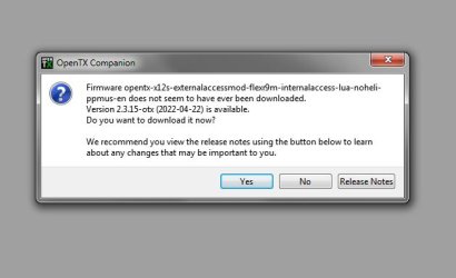

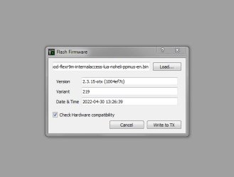

Well... I gave that a try... doesn't seem to want to respond. Maybe I am missing a step somewhere?

So I need to amend my early statement. While the computer recognizes something has been plugged it, it is not seeing anything attached to the USB port.
So... I am back to the drawing board.
At this point, am I looking at just replacing the main board?
This might be the old USB driver problem. Your radios usb firmware is too old for your computer. You might have to run Zadig in order for your computer to see it. In that case once you run Zadig your computer will see the drives and you can go from there... I havent had to do this in a couple years so the details are quite fuzzy. I am sure there is info on this out there.
Not a guarantee, just a thought...
