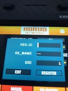

New to FRSKY and just purchased a new X10S Express but running into a couple issues. 1) Transmitter does not Register with Receivers (RX6R). The Reg ID is not populating and the Register button never activates. I had a local club member who is knowledgeable with Open TX look at it. Same results from him. We loaded the latest ISRM firmware and RX6R upgrade with no luck.

Henry, Thanks for the advice and I followed the instructions. With Transmitter on and on the Int Module page I then held the Bind pin down and turned on the Receiver power.
The results were the two LEDs where lit like you noted. When I pushed the Register Button I received a voice "Internal Register". The Express FRos has an additional "Register" button but it is grayed out and I can't get to it (see attachment). The Reg ID also does not populate. The Transmitter is support to supply the unique Reg ID for the receiver but it looks like it is not.

1) when setting up a new Model, the Reg ID. was not proving a 8 digit number. We could never get to the point where we could select the second Register button once registration process started. Not having the Transmitter provided 8 digit ID was an issue.

Resolution Steps = $$$ Finally, We loaded the OpenTX software directly to the Transmitter via a laptop and that resolved the issue with the Reg ID issue. We now had the Transmitter providing the 8 digit Reg ID.
