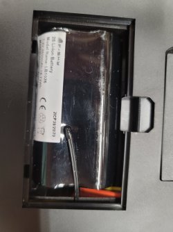

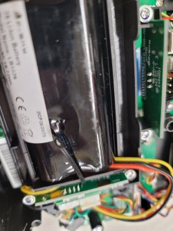

How can I tell if my X10s is the older or newer version. (not the Express)
Mine has a battery door and the battery looks to have a standard balance plug as the only output. It has red yellow and black wires. I notice there is a wire that lays over the battery between it and the battery door that I assume is a temp sensor? That wire stays in the radio when the battery is removed.
Not sure if I need a special battery or an off the shelf type.

If it is not an EXPRESS you have the older battery with the board. Though I am not sure by what you mean by a wire laying over. Picture?
I'm confused. My memory may be wrong, but I think only the Express has a battery door. Earlier versions you had to turn screws to get to the battery.
Yes the older version non Express X10/ X10S version did not have a battery door on the rear of the radio.
You can see the sensor (I am assuming its a sensor) in the photos. The wire runs to the board that the battery plugs in to.
The battery has a standard balance plug on it as its only plug and when plugged into my battery tester I can see the voltage of both cells as well as the total voltage.
From what I see a standard Lipo should work? Or so I think.
Of course I did not cut open the battery to see if there is a board inside of it.

The image says X12S battery. Are we talking about the same radio. X10 / X10S is a different model. The X12S was never Express capabile.
