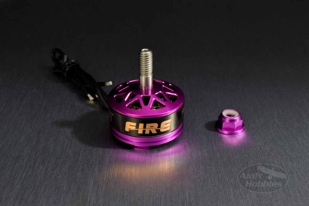

After playing with a bunch of numbers I'm going to outfit mine with a light weight setup. A DYS Fire 2600kv motor:
This is what I am looking at doing with it:
(I did not enter the aircraft weight for the calc above, so ignore the thrust to weight value.)
I might start of with the Emax Avon 2 bladed prop just to see what it does, they are an interesting prop, but not going to be as aggressive as the APC 6.5 pitch:

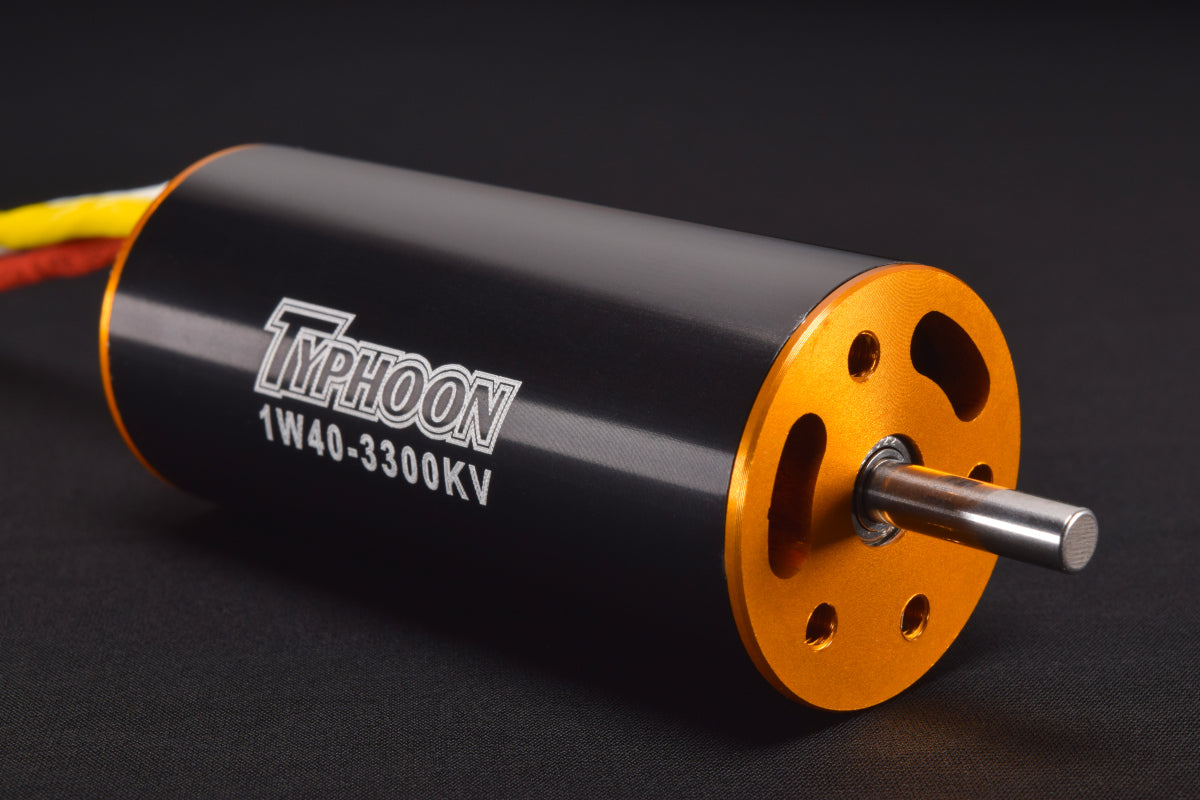

I started off with the Quad motor out front but this created an issue with the CG, just too light and had to get the battery all the way up in the nose. This powered the plane fine, but battery was limited to 3S way up in the nose like that, and honestly wanted a cleaner look.
This weekend switched over to an E-flight BL-15 we had kicking around, and with an APC 4.75 x 5.5 prop and a simple 3S battery she was ripping up the sky. Using the FrSky Neuron 60 amp ESC you get all kinds of great telemetry. Starting to like this little ESC alot. Here is the results of a full throttle static test in my kitchen while my wife was trying to sleep. LOL Battery is partially discharged. Amp load drops in flight. (at the field with a full battery we saw 72 or so amps on a quick static test pull, this is about 20 more amps than ecalc predicted.)
Take off is maybe 1/3 throttle. The plane flies super well. I'll have to measure the CG I am at as I have been eyeballing it to this point. I'll say we are currently slightly ahead of the wing bolts. No trim needed, but under full throttle she does climb as I did a crap job of mounting the motor mount. I was in a hurry on my build, I would have liked to have had no thrust angles on this plane, but looks like I ended up with some wonky angles, that is my mistake, not the planes. I think I have 2 degrees of up. I'll have to fix that before I put in a big motor. Maybe just shim it for now.
I added a couple of cooling holes for the motor and a couple in the rear of the plane. I don't know that they were needed as everything stays cool in flight, with the battery giving out a bit of heat. Voltage sag at full throttle is a thing with the 75C battery, but that keeps my 60 amp ESC in the happy range. Honestly I find myself flying this like a slope glider - When it slows down I blip the throttle to maybe 50%, and that gives me enough energy to glide around do big aerobatics at maybe 75 mph, and will glide pretty far up into vertical climbs, wing over and drop down for a speed pass and a quick roll. Maybe blip the throttle again and do a huge loop. Every now and then a full throttle pass for the bystanders. She is FUN!!
I passed the plane off to 2 other pilots. That is how easy she is to fly. I was totally comfortable doing this. Pretty sure one of these pilots has only flown foam and or wood electrics. He had no issues. A lot of pylon planes are very twitchy, but not this one. For a tiny 1 meter plane she feels big and easy. But don't let her get beyond your sight limits, she is small and SKINNY.
We will have some very nice aluminum spinners in the near future and I'll finish her off with one. That should pick up the efficiency nicely. I really wish I could put a folding prop on here at this power level. (We are looking at getting some all carbon folding blades made for speed ships!)
This motor worked out really well, and for the price of FREE it is really hard to argue with. I'd say the speed was around 100 mph, maybe a bit more. Layout in the plane works well and the 3S 1800 75C battery is happy and the back of the battery is even with the wing bolts. So plenty of CG to support a heavier motor, and you can stuff a lot more battery into this plane. For now I really like the 3S setup on this motor. I'll stay with this for a while and dial in the CG and my throws, to get the most from the airframe. Later, I'll remotor to an HET on 4S as the BL-15 has too much KV for any more voltage, I think a 4S on it basically buys me 3 mph more. Funny thing is this would be a really fun plane even on 2S battery. She needs almost no power just to fly around and have a bunch of fun. I might give that a go just for fun. Something like a 2S 2600 and fly for half an hour or more. Our flight with the 1800 was something like 9 minutes.
